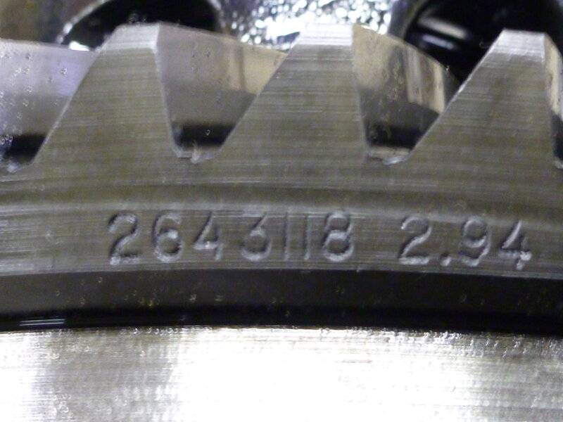

One of my all time ratios are the 2.94 if you can find them. I have run that in several cars and play with rear tire height to dial in.
MY 2 cents.
2.94 is what I have in my Bee, but your clutch won't love you starting on hills and the Cops won't like you on the highway....:D
