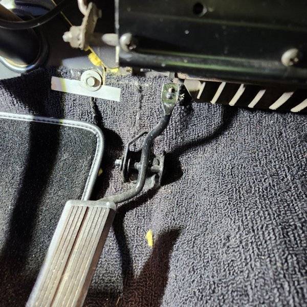

Here's what looks like a 71 up B body or E body,maybe others after that. This is in a 64 Fury I'm working on.
I made mine a hang down pedal. used the stock 64 pedal part that bolts to the firewall. you have to cut off the part where the roller is. it will need to be drilled and tapped to fit the bolt from the a body pedal. you will need to find a 67-69 a body pedal to get a pedal pad,spring and bolt that goes through the pedal pad. i will try to get some close up picture.
