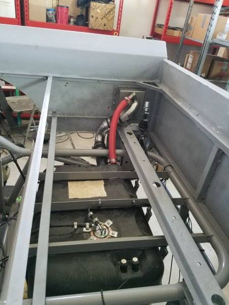

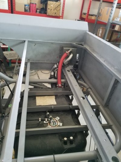

I have a 74 Satellite Sebring with a 318. We removed the charcoal canister and line from the gas tank during the rebuild. I currently just have a hose attached to the outlet on top of the tank.
What have you guys done when removing the charcoal can? Can I plug it off or will this cause issues? Put a filter on the end of the hose? Any help would be greatly appreciated.
