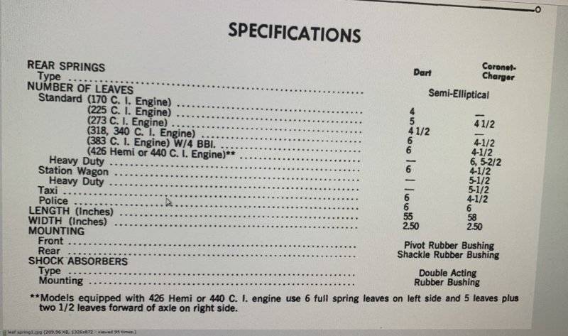

I have a 68 Charger R/T. The leaf springs have 5 leafs on the left and 6 on the right. Was this a factory set-up or did they come with 5 and 5?
In chart form...
