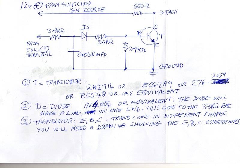

I do not understand how it can have a 'pick up'....but not be electronic ign [ Post #1 ]. Maybe it is a Pert dist with a module inside? If so & the module is HEI based, it may need a filter [ below] if the tach was designed for use with a points dist.
