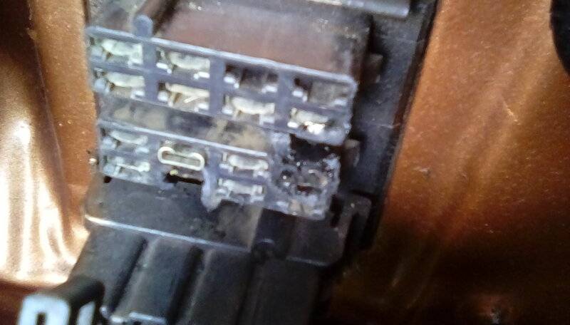

May have found the problem. Checked the bulkhead connector and found some melting issues. Who carries these ?

So the new bulkhead came in I started the replacement process. The melted terminals are impossible to remove from the connector. Question: what name/number are the wiring connectors, (female), and where can I get them? Normal female connectors would work but they don't have the locking tabs on them to keep them locked into the cavity. Some wires will have to be cut.
58 series Packard connectors. Better off by-passing those charging system output circuit bulkhead connections altogether.
That's the issue. Three wires/terminals are melted in the cabin side of the connector. Engine side all are fine.
