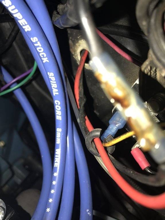

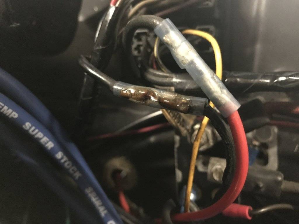

Crap. Looks like I caught this in time. In the pics you will see scorching on the butt connector. You will also see that the black wire next to the red wire has started to melt it's coating and is now sticking to the red wire. Looks worse under the dash.
I still don't see why this is happening but looks like I finally need to rewire this thing.

That the connections turn so hot that it melts the insulation is most likely caused by the fact these type connectors are not made to handle these type of loads.
Best is to solder them together to make a solid connection without the chance of creating a bottle neck. (specially if you want to up the Amp rating of your alternator you cannot have these type of connectors)
