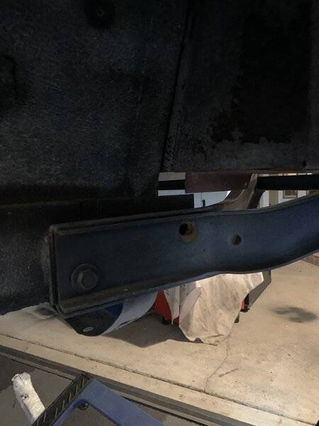

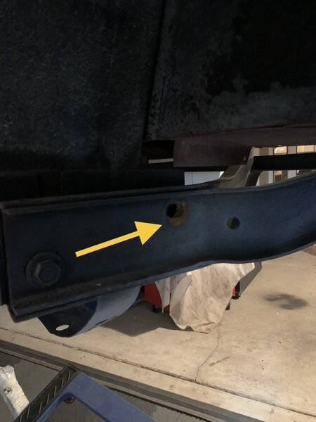

Hello, I need this bolt that is missing from my project. 1971 Charger. Where can I buy one, or size and length so I can replace with a hardware store one?
passenger side, right front.
Thanks always!
DE854088-7AB4-4C5B-ADC9-DF57A4FC602C.jpeg 592853EF-DA64-496E-A14D-4AFABA1B1F28.jpeg
It just holds the front bumper on. Support the bumper and take the other one out and take it with you to the hardware store (the bolt at the rear of your yellow arrow).
I have some original factory bumper bracket bolts if that is what you need. Let me know.
Follow post #2. Just take the bolt from the other side bracket, match it as close as you can at the hardware store, the length may vary a bit, get a grade 5 or 8.
