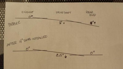

Finally got around to checking and hopefully fixing my pinion angle. This is in a 318 poly 4bbl so I am not making any axle twisting power and it is a street car. Installed my super stock springs about 2 weeks ago, and my pinion angle was pointing up. So I ordered some steel shims (4*) and got em installed today. Below are what I measured before and after with all 4 wheels on the ground. Is this good enough for a street car? I have heard 5-7* is ideal but for what and what angle? Both engine and rear end are horizontal to each other.
For regular driving you are good to go. If your going to drag race it I'd tip the pinion down another 4-5 degrees. It gets tough to get the rear leaf spring pin to locate a thick shim.

Thanks, it seems to drive smoother too. The 4* shim looks like max without cutting and re locating the perch. There is enough of a nub to locate the springs on the axle with this shim but no more. I may tack weld the shim to the perch just in case.

My car is so low that the rear diff is actually higher than the transmission - meaning my driveshaft is angled UP. Since my trans leans down, I had to trim my rear diff UP to get the alignment right. I used Allstar aluminum leveling shims between the axle and the perch...

Johnson Magnetic Protractor Angle Locator. Bought it off of Amazon for about $14.00. I followed the service manual instructions. Measured driveshaft angle, measured pinion angle (flat pad where pinion snubber mounts, 741 case), and front of harmonic balancer. My rear end was factory so I dont know how it got out of wack.
