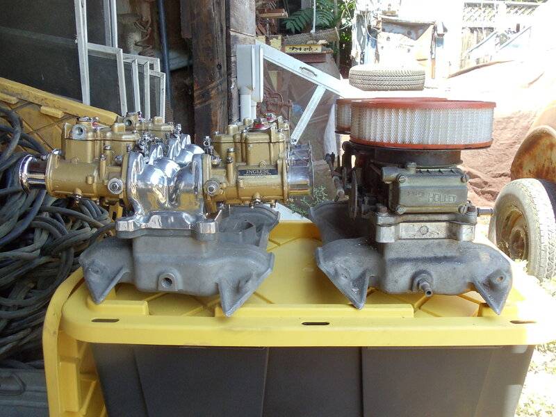

ring and bearing the lower end , slap a afb package with an alum intake , those 452 on her , put a stock hp cam , duel exhaust min , headers best hp . and don't forget the trans , at least a shift kit , and brakes to stop you new monster ! i'd did it to my 130k miles 383 in my 65 , i just twin fours , then 6 pack , never put the webers on it . it was a great driver / hot rod . easy to driver with okay performance .
