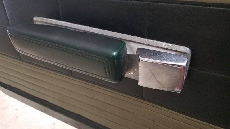

Can anyone recommend a decent chrome paint for the armrest bases? Just for a driver so I don't expect 100% shiny OEM but would like to bring them back to life, as opposed to what they look like now..thanks!
Original finish is about completely gone...
Did they come chrome? I refinished my armrest and instrument cluster on my 65 Satellite and used SEM 15083 Silver spray paint. It looks great and matches everything else
They were most likely chrome when new.
None of the aerosol "chrome " paint looks like chrome. You might as well buy silver or aluminum paint because that's what it will look like. Spend the extra money and buy reproductions if you can. I got mine at Classic Industries and they were an exact match and the chrome is beautiful. It will be worth it in the long run. If you can't do that, maybe go ahead and spray them, but just don't expect them to look like chrome. They will look better, but nothing like chrome.
Yes they were originally bright and shiny...and yeah, I know most 'chrome' paint comes out metallic silver-looking but I was hoping there was one that's a little better than that. I don't expect to get OEM finish from a rattle can, just close enough..without forking over $100 for new pieces of plastic since my originals aren't cracked or anything. Thanks for the ideas guys!
