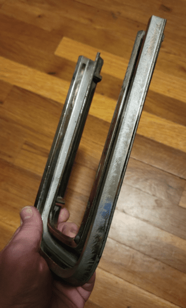

Hey all,
I am to the final stages of rebuilding my 66 Dodge Charger. The rear taillight bezel chrome is not great.
I am thinking about trying to rechrome DIY style but I am also looking at Chrome powder coating. Being the in the rear, the chrome trim does not see road wear, just weather wear so maybe powder coat would be OK.
Eastwood sells a Chrome powder coat material so I am looking for any opinions on Chrome Powder coating.
Thanks in advance.

So if I were to prep (sand to say 400 grit) the chrome molding on the back, then powder coat, do you think it should hold up as it is in the rear, not up front where rocks and dirt can chip it?
I suspect you'll have a couple things working against you with this: the metal would have to be much smoother than 400 grit sanding. The powder has quite a bit of flow agent in it to help create the smooth/shiny surface. This is pretty much the same for any high gloss powder. You'll end up with rough sort of shiny looking trim. A specialized media blast might level things out enough to help the final appearance. We used crushed glass/plastic media with good results, but that still won't fix depressions from the corrosion.
You may be able to hide some of the surface irregularities with a powder primer, but with a prime coat, chrome coat and possible clear top coat you'll have a pretty thick coating which may start to affect the sharpness of trim lines and edges.
If you don't clear top coat the trim and wash your car, which I'm sure you do, the detergent will likely affect the appearance.
If you don't clear coat and the car sees much sunlight, the finish will deteriorate reasonably quickly.
Stop by your local powder coating shop and talk with them. Most, but not all shops welcome walk ins. Try and find a shop that caters to the hobbyist. We used to advertise in local club/association newsletters/publications.
If you don't mind shipping the parts, the above mentioned resident forum powder wizard can help you sort through your options.
