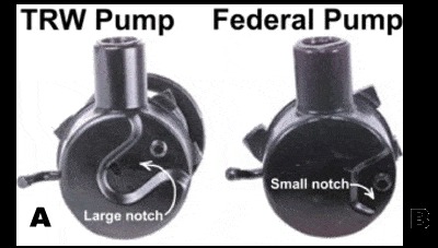

Hi Guys,
Have a leak in my power steering pump and need a new O-ring. How do I tell if my pump is a Saginaw or Chrysler? It is a 1970 Dodge Charger 440.
Thanks
JB
Saginaw on the left, trw/federal on the right

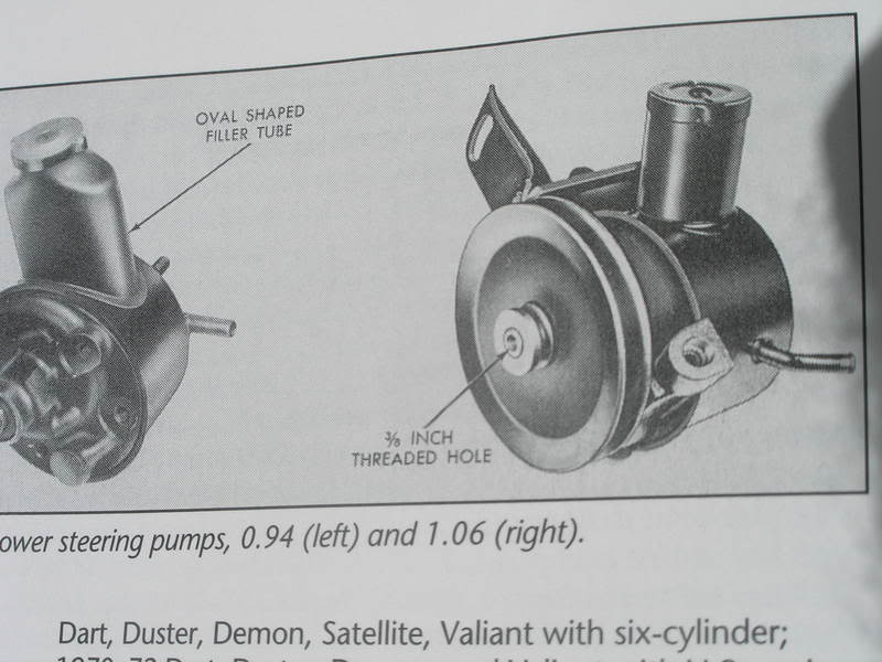

Thanks, mine looks just like the pic on the left top. So that is a saginaw?
Left top is Saginaw, reservoir neck has an oval cross section..
