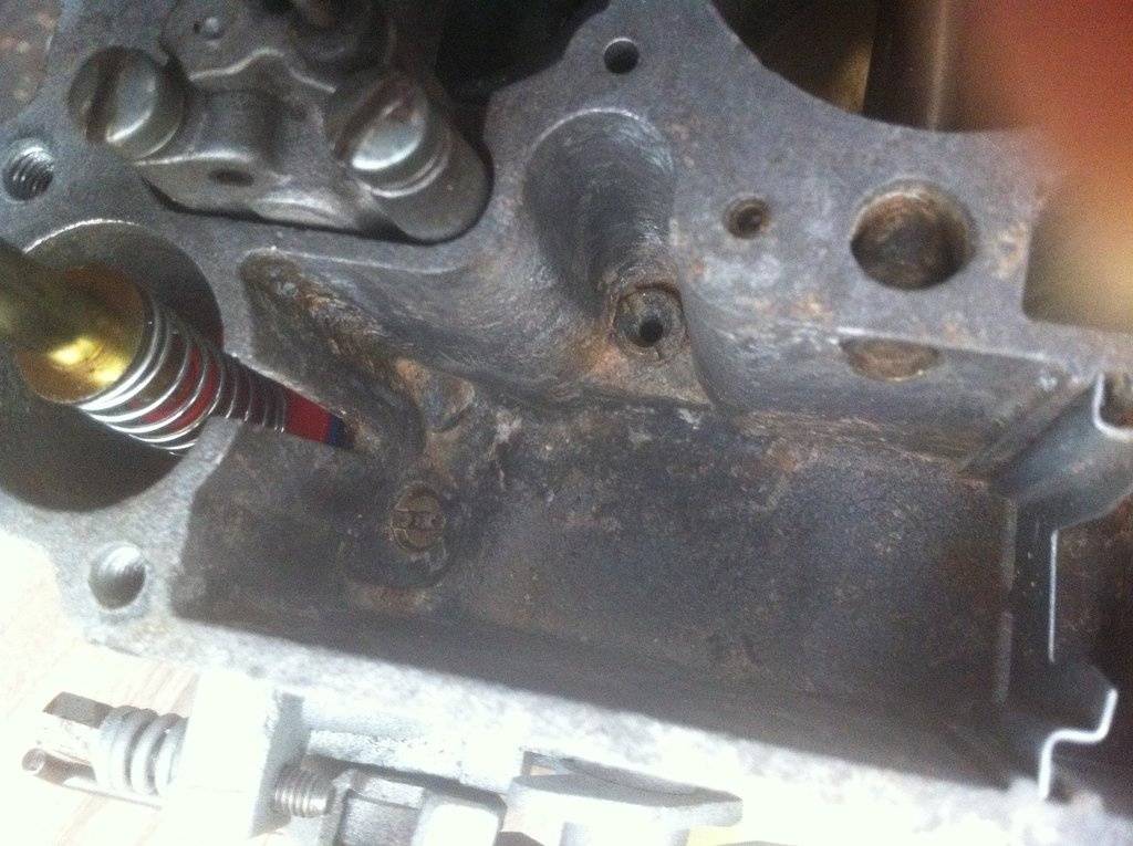

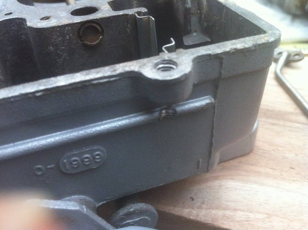

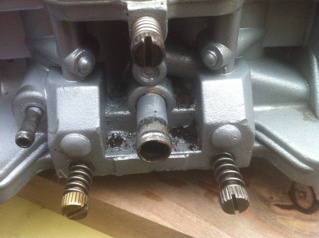

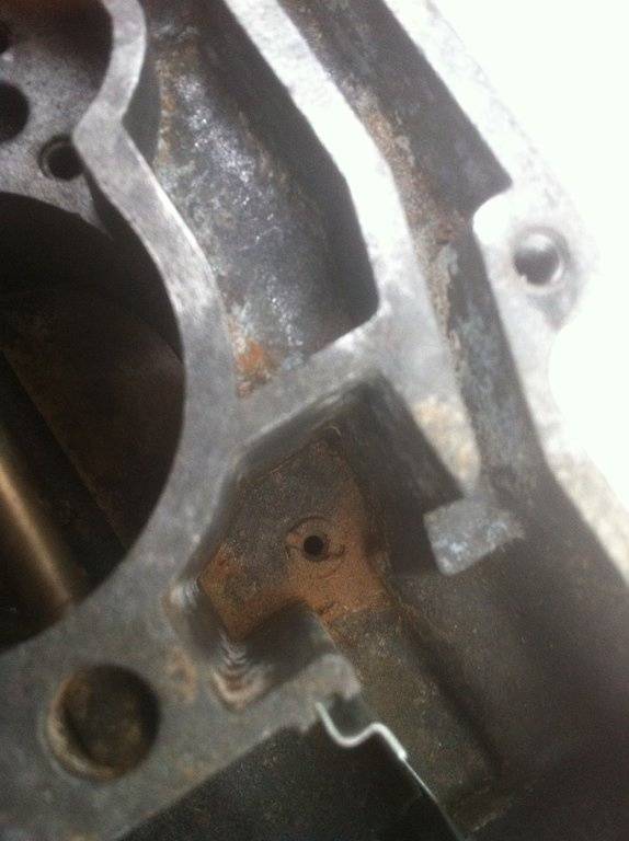

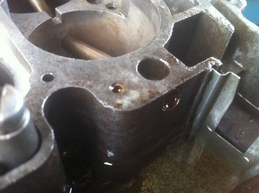

Just got burnt by Chuck Rosa , trusted him with my 69 #matching AVS. It came back with the wrong screws for the top, too long, bottomed out, gouging both sides as well, secondary leaks like a sieve, shutting down my fresh rebuild, fuel dripping from primary shaft as well. I contacted him and he told me to find a real mechanic, said i dont know what im doing. Regards. Should of read the reviews. He even charged me an extra 100$ to drill and tap my non-functioning idlers. What a bummer....im out 600$ and he fuped uck my carb. Apparently he spray bombs the carb and throws in a jiffy kit. Stay away....
those carbs are extremely easy to rebuild. go back thru it yourself.
Why would the left secondary leak , im gonna go with a cracked passage!
Spray painted over dirt inthe corners
Looks like crap work to me . My wife could /does do nicer rebuilds then that . Not sure why you even bothered if you want it done right do it yourself! All you can do is write a review ,or go kick his *** and burn his shop down depending how mad you are !
Yikes! The guy needs to invest in a soda blast cabinet at least, that is no kind of way to perform a rebuild

Anyone with any carburetor experience can look at the pics above and know it was a crap job.....
