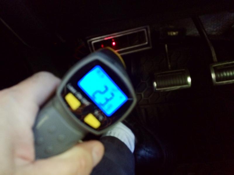

Sorry you had this experience. Did the FABO site users give you a heads up? My 69 B non-air was not a problem according to my installer and it has been 32 degrees at the vent for 8 years now without a recharge. How long ago was the kit purchased?

My experience is different. Been to the shop in Tampa. Not a nationwide operation. Ice cold for almost 10 years. Never a recharge. Life saver in Reno heat.
Performance is everything in this case.
