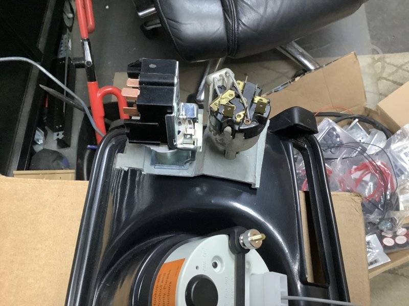

Those who have the Classic dash rallye gauge cluster/ insert...what are you using for a headlight and wiper switch? If using original...how did you go about mounting them? I just got my insert, I'm a little perplexed and any insight is greatly appreciated. Thank you!
I cut out the pot metal section off of the original gauge and trimmed it to fit and also ran ground wire for the wiper switch and it looks reasonable and works great. They are snug and don’t turn in the hole when you use them.

Yeah if you have the rally style switches you're in better shape than me. I'm not shy to spend money, but I figure I'd try to make what I have work first. If you were a talented machinist, you could probably modify the non-rally style to work, but I don't have any machines or talent. I'm not 100% sold on my solution, but I think it'll work OK.
