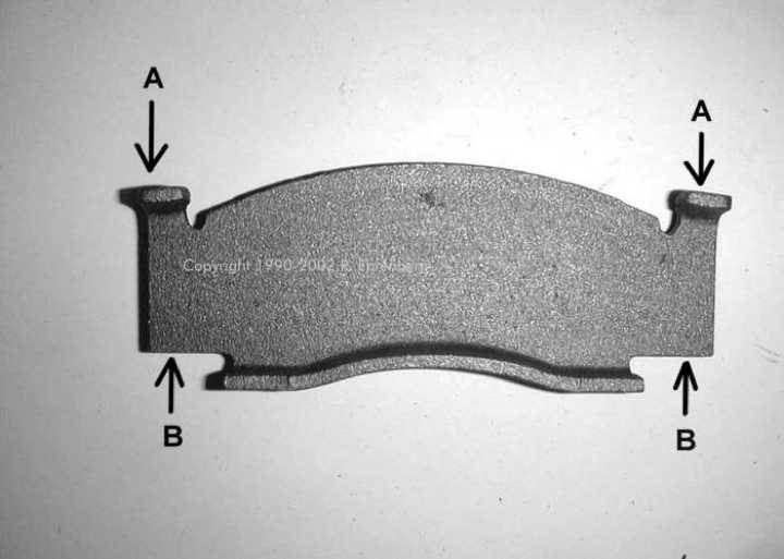

The outboard pad has tabs. Recalling from memory the tab facing the front needs more bend downwards than the back tab. It will clip in the caliper tight when you get it bent properly.
So those outer tabs were already pre-bent at a 90 degree angle on my pads. Are you saying they need to be bent further? I'll mess around with that when I get time this weekend.
Yes, bend outer edge of tab further down. Tap with a tack hammer.
See quote below:

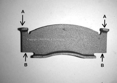

"Sliders need to have the outer pad custom-fitted to the caliper. Hammer the tabs (A) while supporting the bottom edge (B) on an anvil, brick, etc. The pad should just barely “snap” into place on the caliper. Too loose? Won’t fit? Bend again!"
See photo halfway down the page in this link:
http://www.allpar.com/history/mopar/brakes/disc-main.html
Thanks, that's it. The instructions I received were horrible. I read it last night didn't see it anywhere for any other adjustments that need to be made. I'll get that fixed this weekend. Thanks
