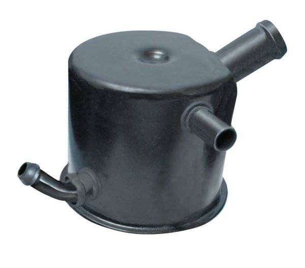

70/71 type breathers have three ports one from air cleaner one from gas tank and one going to the carburetor. In 72 they changed it to just one going to the air cleaner because they introduced the charcoal canister in 72. I can’t find this 3 port type of breather brand new anywhere .
Is this the type you need? If so, you can get from 521 Restorations, a sponsor on this site, here is the link, its listed at the bottom of the page.
http://www.521restorations.com/index.pl?page=allmodels&sub1=Engine
I suppose you could use on the 2 port one, and it depends if your carburetor does or does not have the port for the one purge line and if you are trying to stay original or not. I have just the single port one on my 73, so yes they are expensive, but good quality, although I did repaint mine when I got it.

so I cleaned the breather with carb cleaner it seems like it did the job. Lots of brown came out when sprayed the inside with the straw it came with from brown to clear fluid then i filled it with 10w30 motor oil and let it drain out for a half hour. I just now spray painted the breather with semi-gloss black paint. Now letting it dry. I think the carb cleaner did the job $2 a can at walmart

I just purchased a new breather from AMD and it is exact as the original 99.9 % the same it was impressive the inside too. It comes plated so I cleaned it up and painted with gloss black engine paint. This is an authorized Chrysler product. I put some 30 w oil in it and let it soak right side up, than turned to drain, all set and will install after work today. I paid about $47.00 from Mancini Racing with 7.50 shipping to MA.
