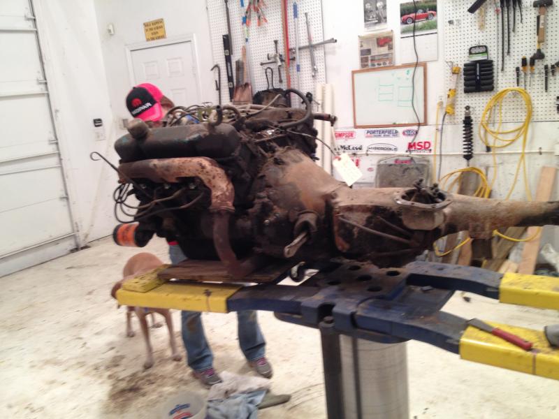

Good afternoon Team B Body folks. I have the Engine and Trans out of Sassypants (66 Coronet Convert) and it is a GREASEBALL. I can get to a "hot" pressure washer that goes to 140 ish degrees. Question, how do I prep the engine so that the boys can do their work and have a chance of getting the engine down to what I need to give it a paint job? I have heard about Oven Cleaner, Grill Cleaner and of course the sundry of all those commercial products. So the question, what really does cut grease that has been sitting for 30 years? Any help appreciated.

If you do not care whether you remove paint along with the grease, I've found that EZ-Off oven cleaner works great! Rubber gloves and eye protection are a MUST, as the main content in this is LYE! But damn, does it work! Spray the cleaner, let sit for a couple of minutes, then take a stiff wire brush to the affected areas. Spray again if needed and repeat. Rinse with pressurized hot soapy water, then rinse. Chances are very good it'll shine like a diamond in a goat's ***! Use compressed air to thoroughly dry, then paint.
Engine degreaser and a few blasts with that Steam Cleaner
Repeat, re-apply de-greaser, blast again.
Thank you Very Much folks, that is what I have heard works best. I think I will take a scraper to some of the real caked on stuff, then give her a spray job before taking it to my buddy's garage for the final hot bath. :).

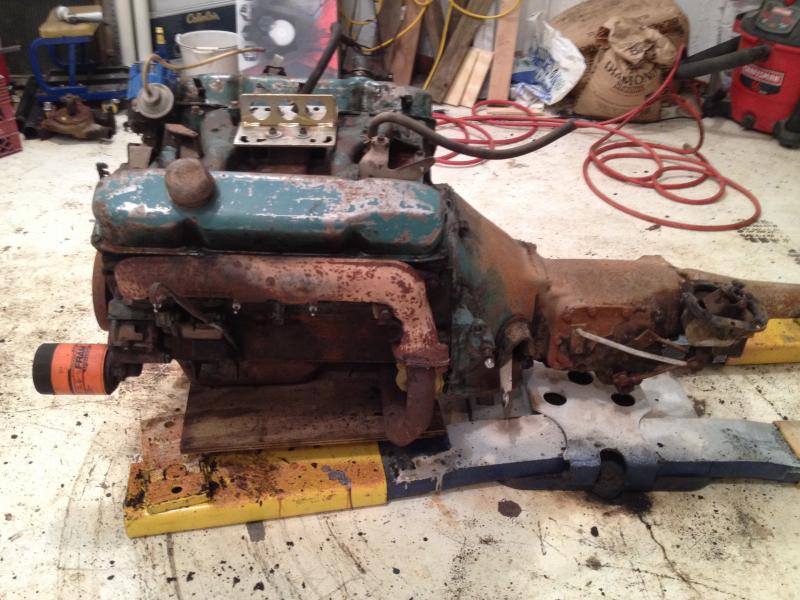

Just getting started with the clean process. It is Saturday Morning. :)
Making Progress. A lot of elbow grease and two cans of oven cleaner plus rinse. REady to go to buddy's warm pressure washer. :)
