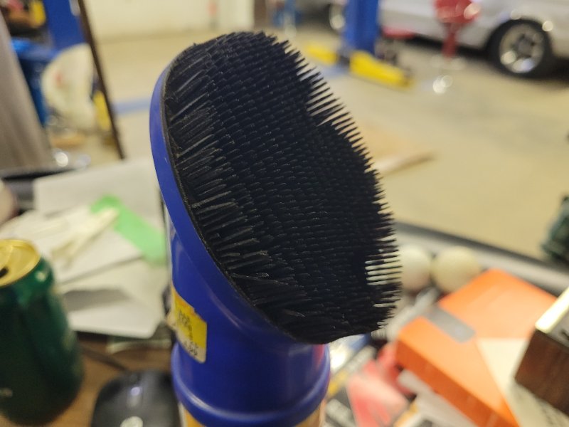

Scrubbing bubbles for Showers. Spray on, let foam and work the grain with an upholstery brush. Wipe clean.

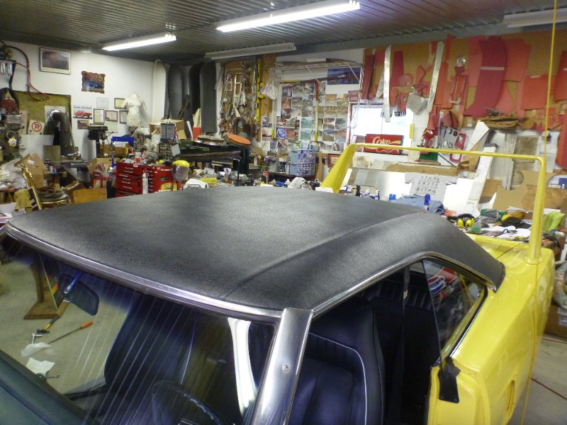

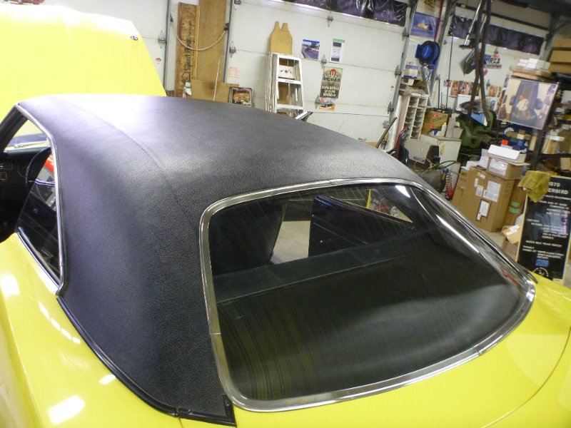

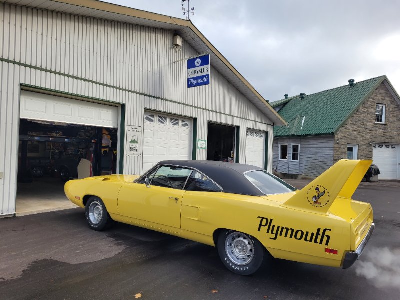

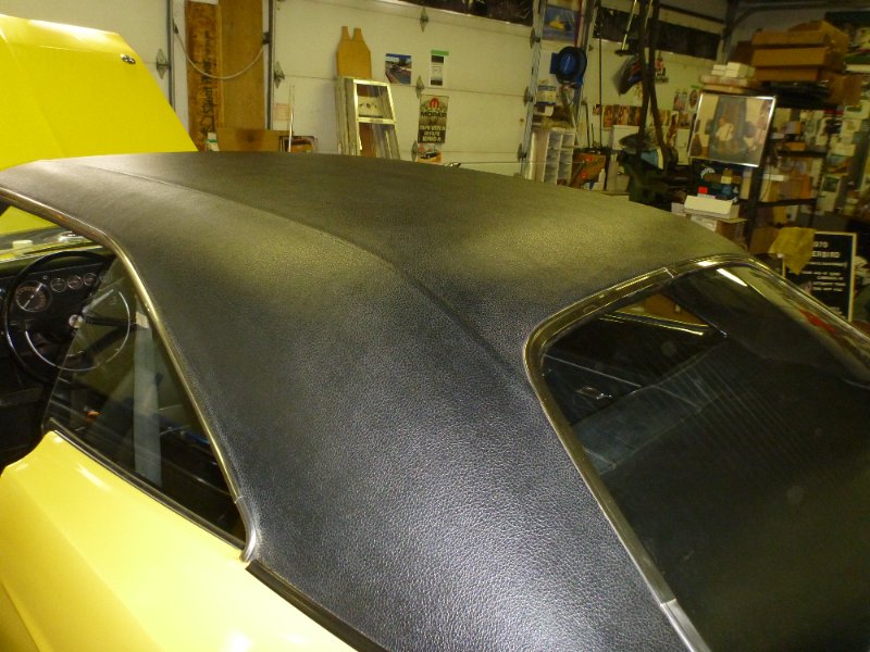

I will note that from 1990 to 2019 I had used every cleaner known to man on my Superbirds original Black top. Would look good for a bit and go right back to looking Gray. Prior to the Aero Reunion in October of 2019 I used Scrubbing Bubbles... it stayed BLACK. It is still Black even after the body shop dust and aftermath, and all I did after that fiasco was wipe it off with a wet towel... pretty good for a 56 year old top
2019..
Today...

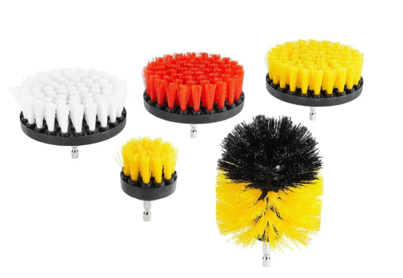

Never been rich enough to afford a vinyl top car... but I've cleaned a lot of Tolex on old guitar amplifiers. Working on an old silver face Fender Princeton right now. I use a scrub brush to remove dust and dirt before scabbing with liquid dish detergent. I never apply a protectant as I sell the clean and dry amps, warts and all. I leave that decision to the next owner. It take elbow grease, so I like the looks of that brush kit
