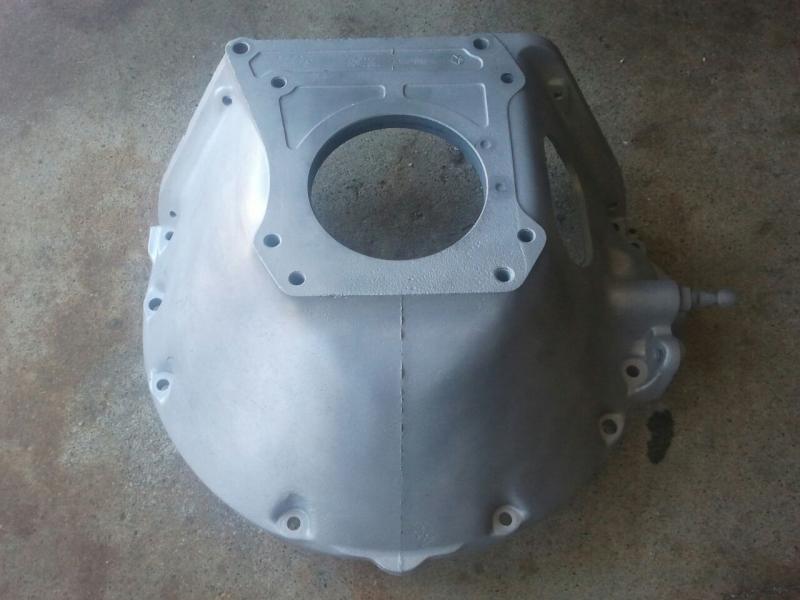

Thanks Cranky, my pressure washer is rated for 2700 PSI and I was up close to it. After putting some degreaser on it the pressure washer helped but I think I was just hoping the process would go a little faster.
I used greaser and glass bead blasted.
