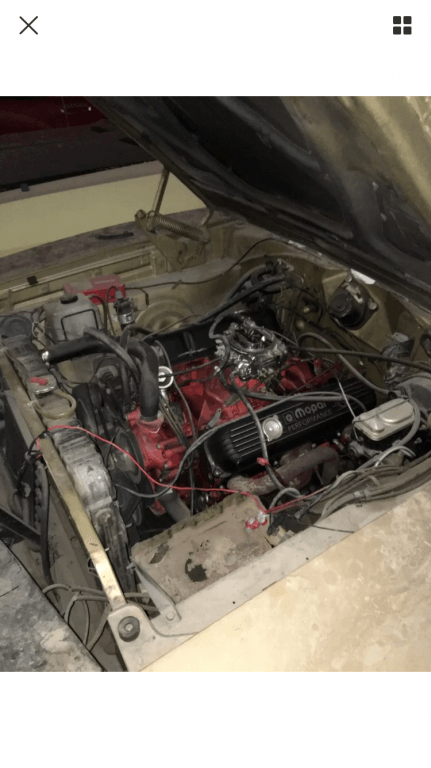

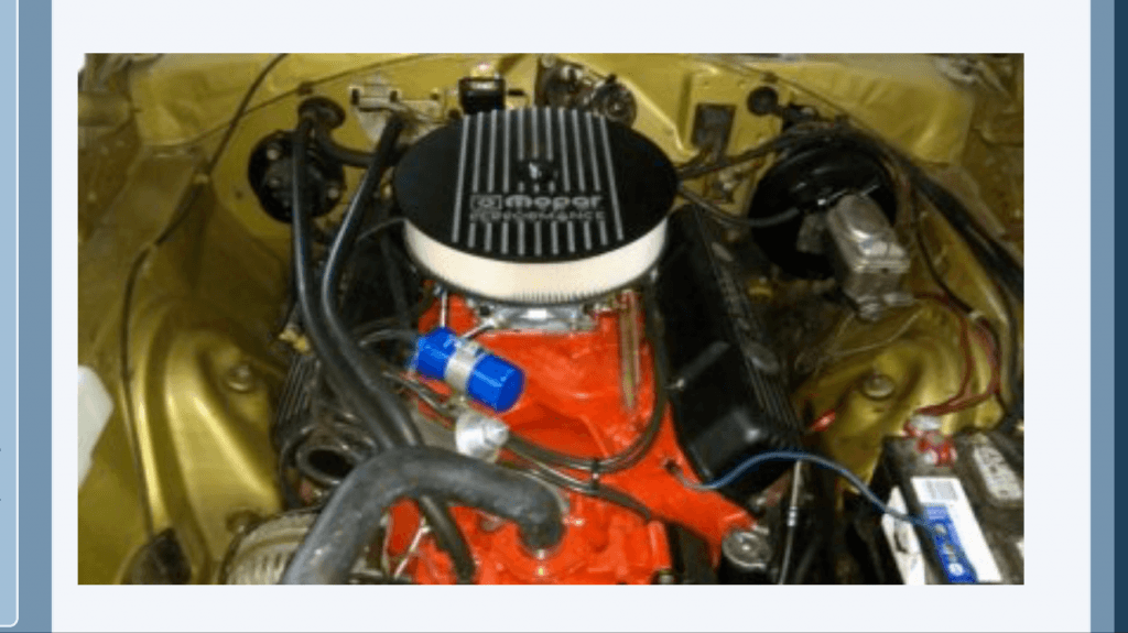

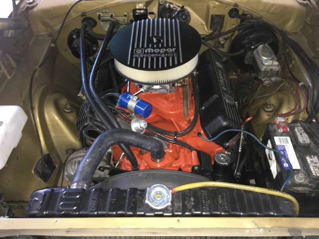

Cleaning can take so Much time. Here are a few before and afters of engines bays both without pulling the motors due to time constraints.
Before
