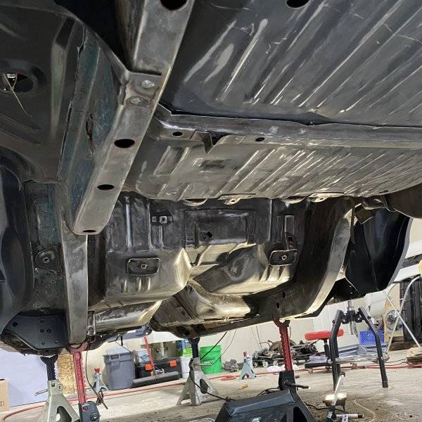

I've made good progress getting the undercoating off, but now I've got this mix of good paint and surface rust -
How should I prep this surface and prime over it?
BTW, I intend to leave the undercoating forward of the crossmember that the shocks mount to. It's in good shape and appears to be doing its job just fine. Removing undercoating is too time consuming to fix what isn't broken.
Wow you did a great job cleaning that area! Looks great. Scotchbrite and Vapo Rust. Keep it wet and
let it do the work. Scotchbrite the whole area and prime with epoxy primer.

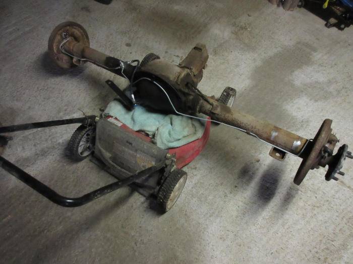

I'll share my special tool for moving that rear end around if you don't have help -
It sure helps to have the rear end, leaf springs, and driveshaft out of the way.

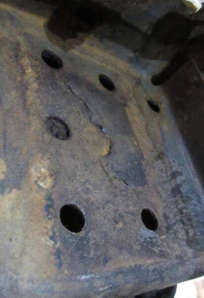

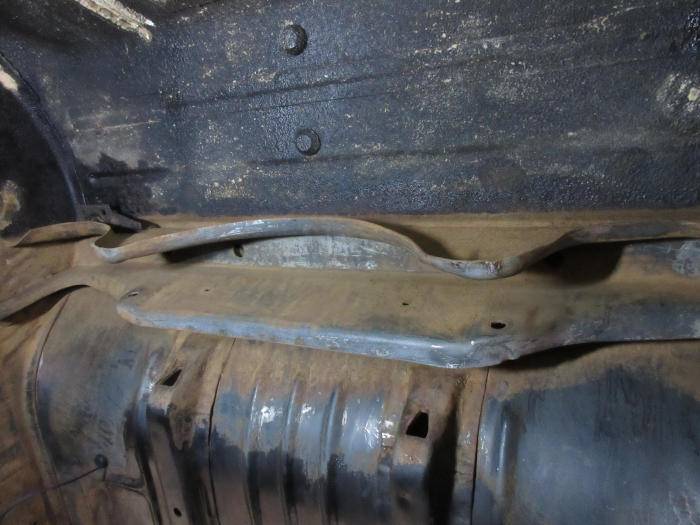

Is there supposed to be something that goes between the front leaf spring mount and this brace? Like the isolators between the leafs of the leaf spring? On both sides I've got this scale looking raised area, but it doesn't appear to be coming from the brace or the back of the leaf spring mount. Not sure what's going on. It sure looks like something is stuck to the brace.

That scale looks like the part of the metal that didn't rust and hasn't pulled away yet, at least that's similar to what I've found here in rust country.
Can it be chipped off?

I chipped it off. It looks like it was a thin sheet of metal between the shackle and the brace. The brace was undamaged underneath and the shackle wasn't rusted enough for the scale to come from it.

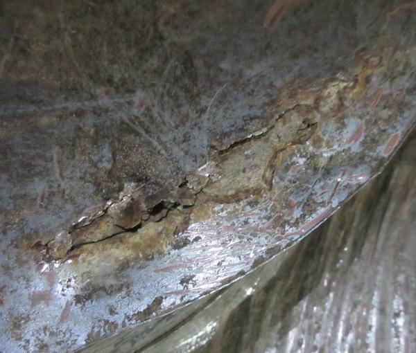

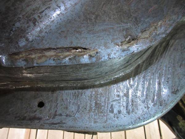

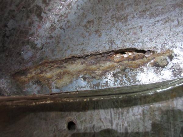

Let's talk about welding skinny metal. I've got a few rust spots to fix - this looks like a good place to start -
I can cut this thin stuff out with my Dremel, but where do I get new metal to replace it with? Any recommendations on a 110 volt TIG welder? I've watched a few videos on welding thin metal, but any tips and tricks are welcome.

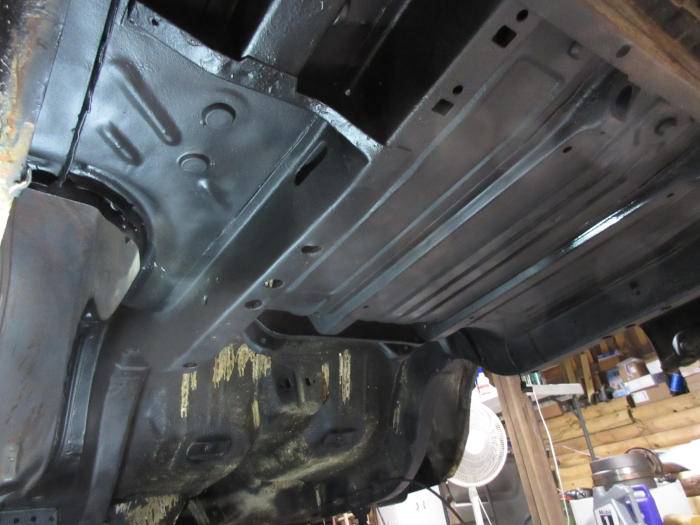

Here's the finished result, sorry for the lens flares. I decided to finish this with Rust-Oleum Rust Reformer and pro grade undercoating. I'll let a body shop handle the rusted out parts, so I've left the wheel wells and the inner quarter panels unfinished. I've got the feeling that this will last a long time, perhaps longer than I do. Or it could prove me wrong and peel off in a year, but I doubt it. I think it's going to be fine for a couple decades and if we're both still around maybe I'll send it to a professional restoration place and have everything done right.
Well hey I think I just found out what that mysterious metal scale between the leaf spring hanger and the body brace was - a thrust alignment shim. If rear end alignment needs to be adjusted in 1/32" increments, I'm going to have to clean the face of that brace up and get it smoothed down for the shims to slide in.
