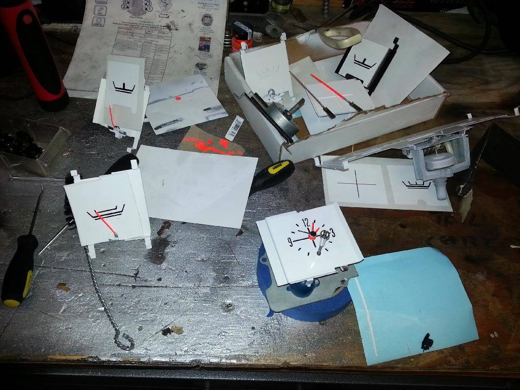

I dont want to screw this clock up but how does one remove the hands from my clock. I want to repaint the face. I pulled slightly on the second hand but im afraid to break it. Thanks
act like your going to throw a ball at it and the hands will reach out to grab it and fall to the table. works everytime
Yes, I can help you with your clock ave rebuild 3 of them now for 68-69 non rally dash. PM me for more detailed info but for the hands they just pop off, ou can use a plier that can grip like a puller but just be gentle and remember they are old and will snap. another way is if the clock is in good working order then make an apron for around the hands then spread the hands out and paint each one individually.
