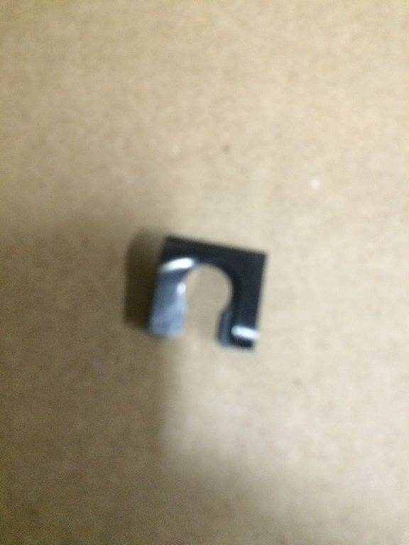

Just Wondering How These Clips Install? Does The Clip Get Full Sandwiched Or Just Half. Bent a Few Already. Thanks
If I understand your question, the answer is "half". If you do it this way, you'll notice the little "hook" on the end sort of clips over the stud pivot.
The full clip goes under the stud, sometimes you can tap them in but usually they pop on with some wiggling and swearing.
Push firmly. They're made from spring steel so they have to flex around the stud. You push them on over the side of the stud - not over the end.
Maybe someone could post a pic?
For me it took a couple of spares in case I got too aggressive "installing" them, and lots of cussing and finger strength.
