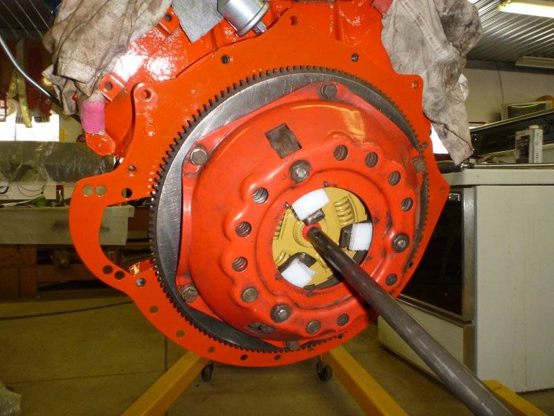

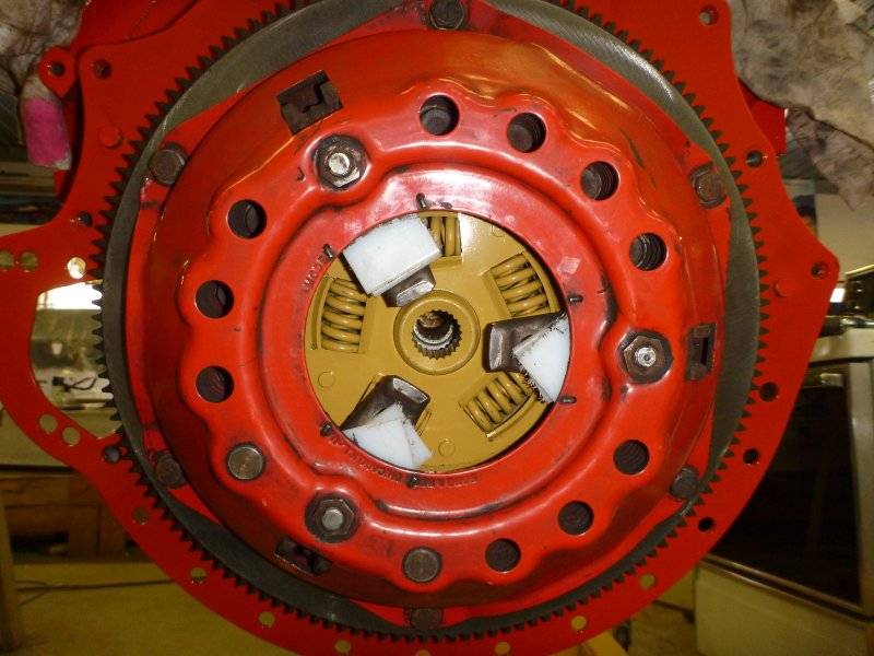

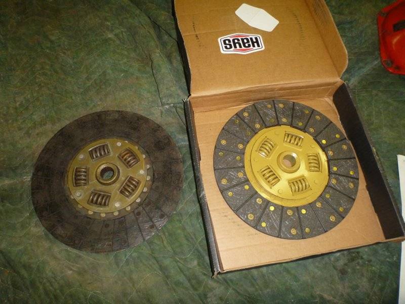

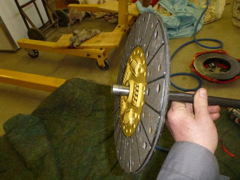

Yep.. I installed mine in 1979 after getting tired of cooking stock chrysler discs after a couple of dumps with my stock 383 Bee. Still using the same plate and threw in a new disc during restoration in 2017. No slip and squawks the tires even hitting 3rd with 2:94's in the back.
First pic shows the old disc was still pretty good after 55,000 HARD miles...
