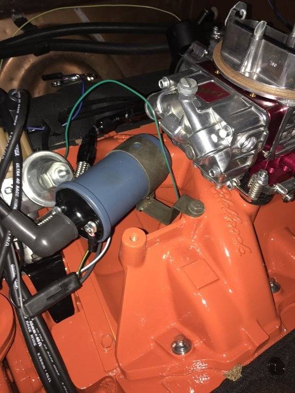

Yes they do make a coil relocation bracket I think I got mine from Mancini

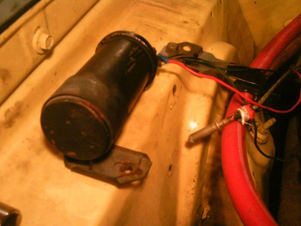

You probably won't want to do this, but I mounted my coil on the firewall when I used the TM-6 Edelbrock Tarantula.

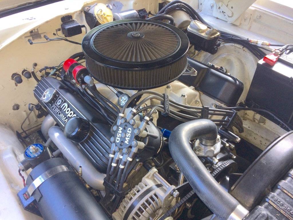

I have an Edelbrock Torker intake,Holley carb,

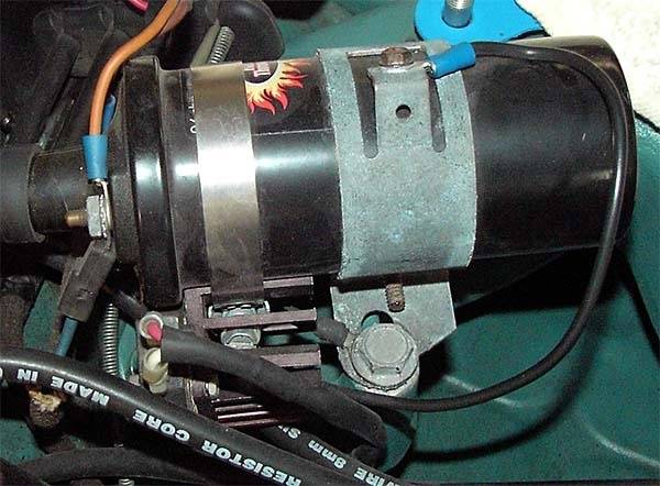

and I have a Ford coil bracket, it fits in the stock coil location. Sorry no pic of it in place, but this is the bracket.

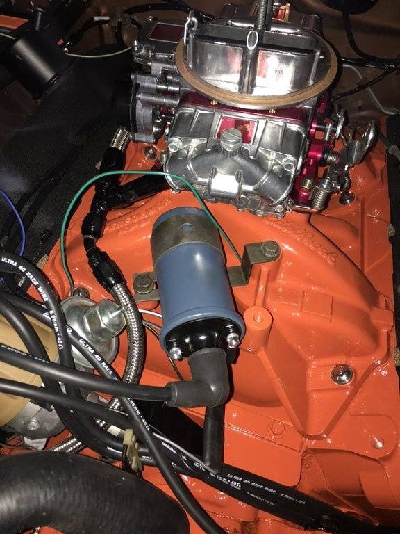

My brother modified my original bracket to fit my edelbrock performer intake. Fits nicely in front of carb.
