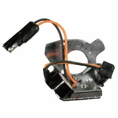

If it's a mopar electronic ignition, it could also be the reluctor gap or the reluctor itself.

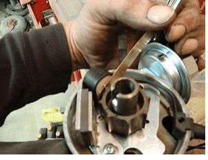

The reluctor gap is the space between the pickup coil it should be about .008" and the reluctor itself which looks like an 8 pronged gear.
If you don't have a feeler gauge about 4 thicknesses of regular paper will be close.
