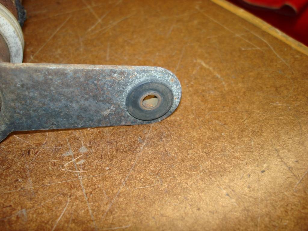

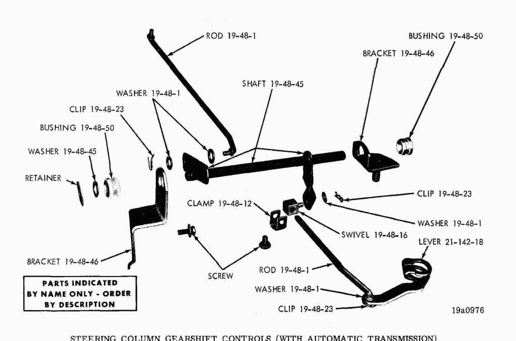

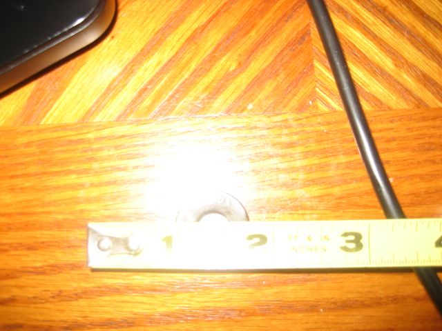

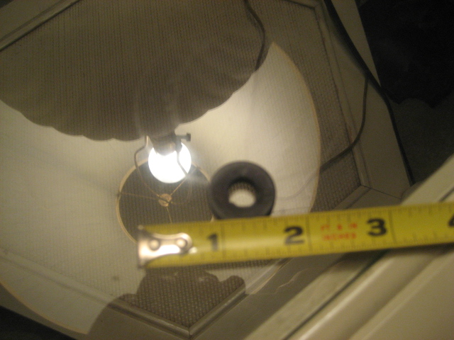

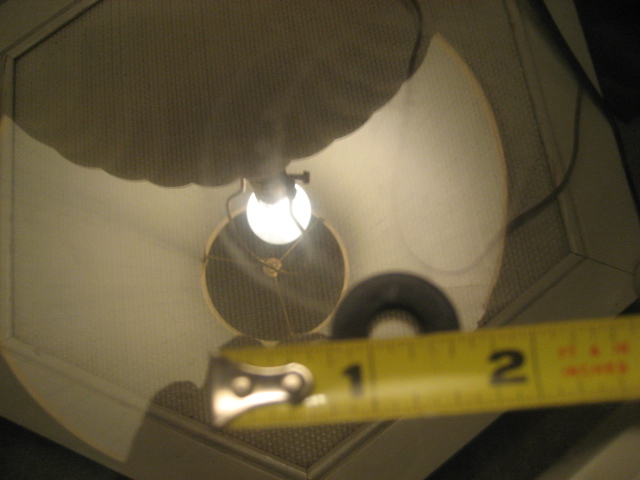

Thanks for the helpful info and I'm getting closer. I think new washers and clip will fix the loose connections at the Z-Bar. After further review my main issue is the busing between the steering column and the rod described above as 19-48-1. Mine is completely missing and the small diameter rod is floating loose in the 1/4" to 1/2" hole on the shift lever on the steering column. I found a reference to this part for a manual column shift on P 21-37 of in the 1972 Chassis Service manual but all it says is Plain washer, bushing and grommet without any details on the busing or grommet.
Rob
Unbelievable

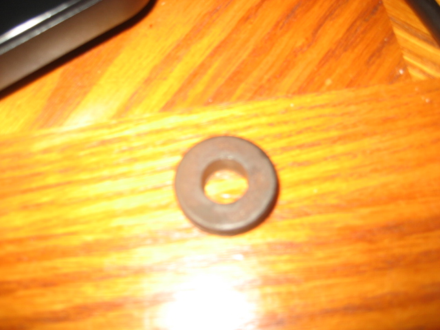

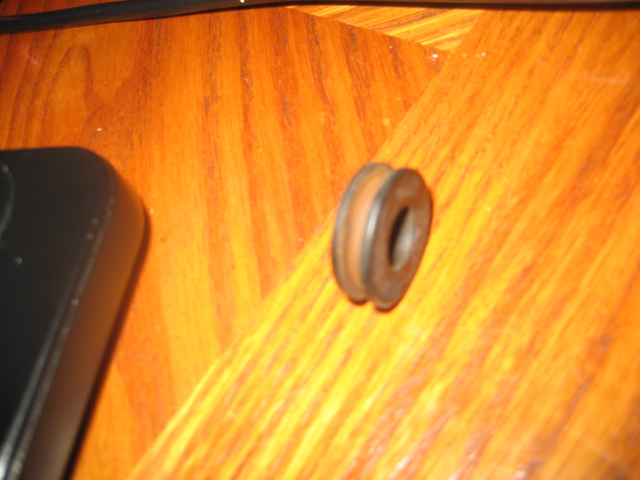

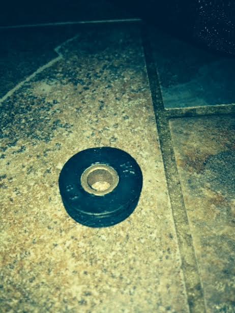

NOS bushing.jpgNOS inventory.jpgThanks 72RoadrunnerGTX!!!!! thanks to your part number information I called my local dodge dealer and gave them the 2 part numbers. They didn't have the parts but told me the nationwide system said that a dealer in south GA had the grommet and a dealer in NC had the bushing and gave me both dealers phone numbers. After a couple of calls I bought both NOS parts directly from the dealers for less than $20 including shipping. 72RoadrunnerGTX Rocks! This website Rocks and Chrysler Dodge rocks for still having these parts. One of the part's label said it had been in inventory since 1995.
