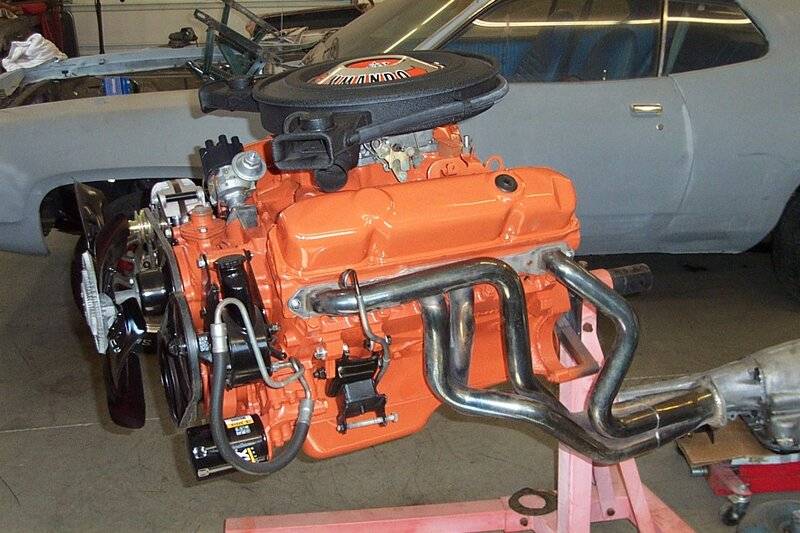

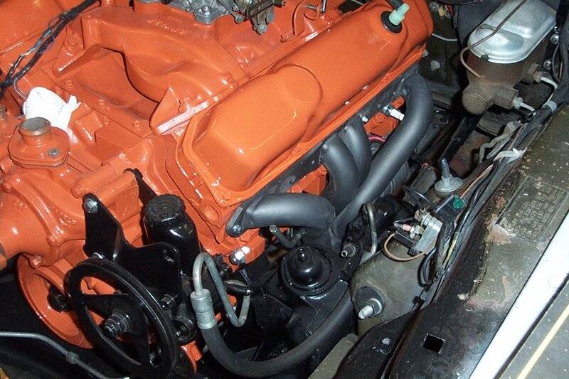

Here is one of mine for reference. This is a 75 cast crank 440 with the standard 70-up BB Saginaw pump.
View attachment 1028722 View attachment 1028723
Thanks for the pictures. Your damper how thick is it? Does it look like the one used on the 383/400? Mine is approximately 2.75" thick.

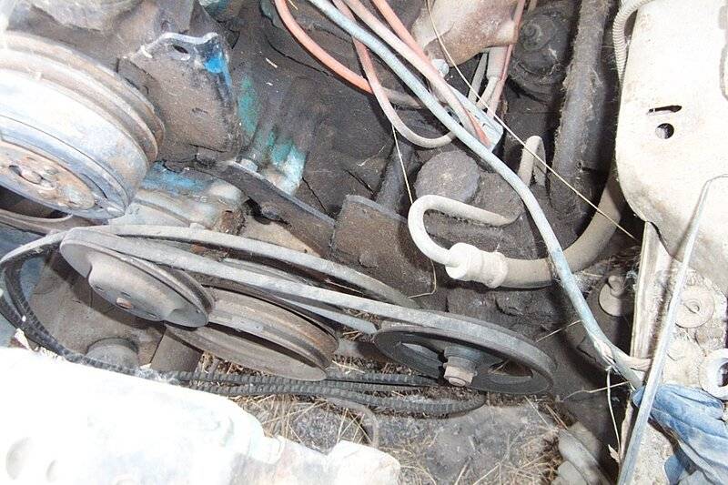

So, I looked at some of the stuff I have, and they all seem to put the power steering way out on the last groove of a 4-groove bottom pulley. I do have one for a '78 400 cast crank, with a Saginaw pump, and another '74ish 440 with that super fat damper and a Federal pump. That's factory on both, and they sure dont look to be tucked in nice, like the photos of the sweet setup in Moparmarks post. Ill try and get a pic so you can see what i see. I'm not sure what you mean about 77-78 specifically tho, lots of car engines were cast crank from '73 on, FWIR.
