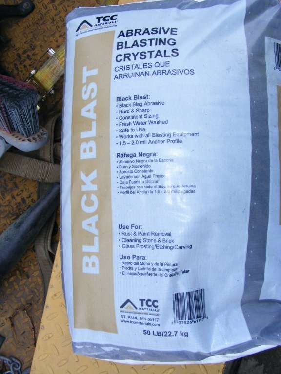

is that the same as Black Beauty, Paul?

Hi Mario, No, the Starblast isn't the same as black beauty. Black Beauty is a super-sharp abrasive similar to Garnet that will do some damage if you're not careful! As far as tank size not meaning anything

View attachment 366821 View attachment 366822
Where do where do you find this abrasive, a commercial outlet?
