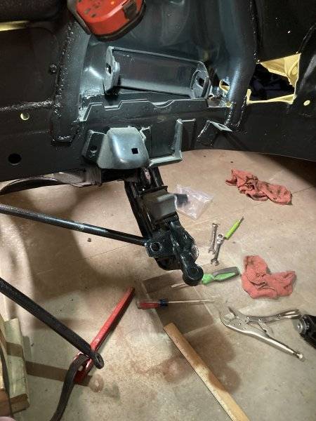

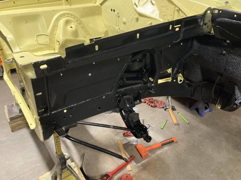

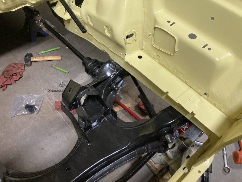

So I am trying to reinstall my front suspension on my 1968 Super Bee. I purchased a rebuild kit, and so far it’s been…..confusing. It’s a kit that covers 1965 thru 1969, so far the lower control arm bushings
fit great in the arm, but wasn’t even close for fitting the control arm bolt (wayyyy too loose). Now, I have the arm, the strut installed and the torsion bar won’t seat fully, due to the gap between the k member and the arm. I suspect the strut is fighting it.
My question is this……the kit came with part #K-7016A Strut Rod bushings. There are 2 in each package……when I removed the strut, it only had one bushing on the rod (fwd of the k member). I installed the second on the backside of the k member….i think that is giving me the gap and twisting or loading the control arm?
Anyone have insight to the proper install of this bushing? My parts manual shows 2 for my car……..any help is much appreciated!!!!

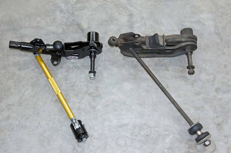

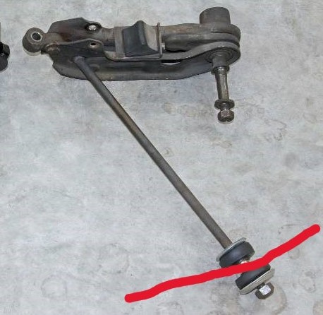

Look at this:
The red line represents the front of the K member. Yes, a bushing goes on each side.

Well, post # 6 was a picture that did show the bushings. I only took his picture and did a quick depiction of where the K member intersected it.
Maybe it helped, maybe not.
I know that if I needed help right away, being the impatient type, a picture helps a LOT more than waiting for a service manual to be sent to my house.
