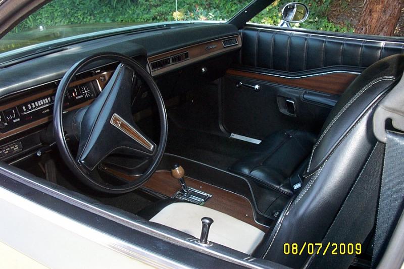

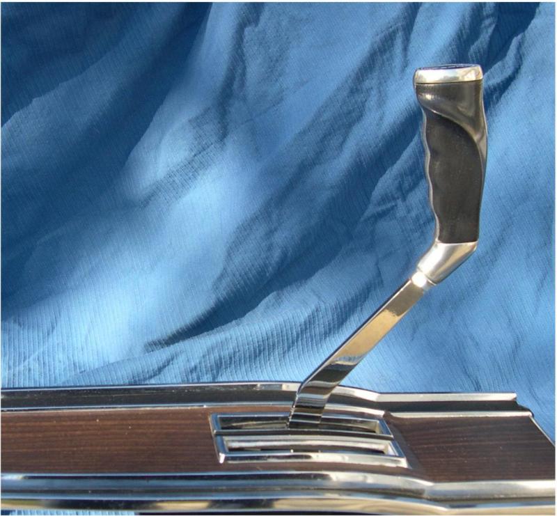

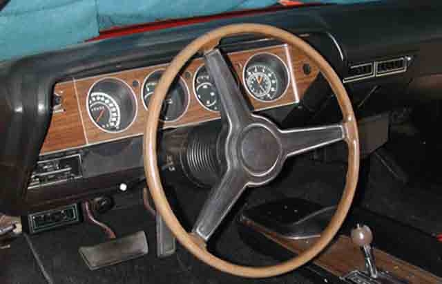

So I've been noticing that the 71-74 Chargers have two styles of console shifters for automatics... I'll call them the "T Style" and the "Ball Style". Looking around, it seems that 71s and 74s had the Ball, 72-73s had the T. My '74 has the Ball, but I like the look of the T better. I've heard that the ball is durable, while the T can be relatively fragile.
Those of you who have the T, thoughts on it? I'd like to switch for cosmetic reasons, but I don't want to go to all the effort if the Ball is going to hold up forever. Another option would be an aftermarket shifter, anyone know what's out there that's worth a look? Below are examples of the T and the Ball (The Ball pic is an E Body, I know... but the shifter is the same as mine)

Ball shifters seem to be cheap right now and use all the stuff the t uses so for less than a $100 you could have both. 4 screws and 10 minutes would be all it would take to swap out. Seems like the ts handles are all broken so they are usually more abused and the detents are usually iffy unless you find a good one. I was just thinking the other day that someone with some basic machine tools should take up refurbishing slapstiks and upgrades. It's surprising noone does that. As nice as your car is, I wouldn't do anything not easily reversed.Another thing about the t handle is you can swap to a pistol grip too. As far as aftermarket shifters, most are more race oriented in the way they shift and detent.

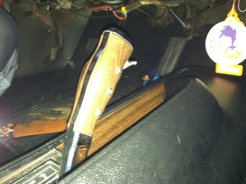

Here is my current shifter...i would like to swap out for a Pistol Grip handle.

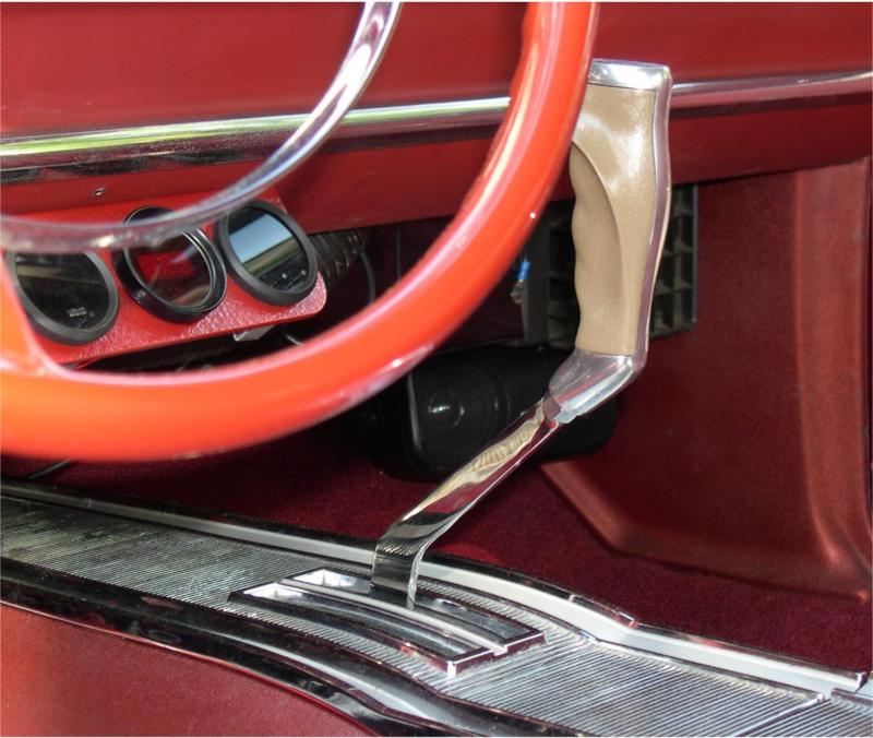

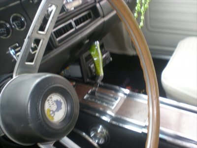

I have a pistol grip in mine, called an Auto-Grip. A guy over on roadrunner nest machines them himself and it's the best looking one ive seen in my opinion. It has a nice lean to it, unlike the gunslingers. I have pictures on my work computer I'll post tomorrow and see if I can dig up his contact info.
I would like to see one myself.. Thanks, what kind of price is attached to them? if you can say..

$175 and includes everything you need to install (which took 2 minutes)

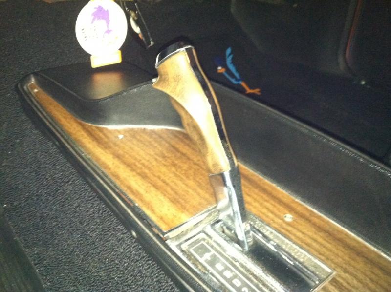

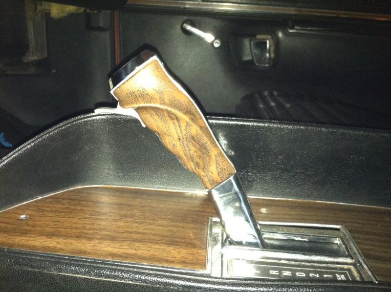

Here are a few pics, sorry they arent the best quality, took them on my phone in the garage, thought i had better ones saved but i dont:

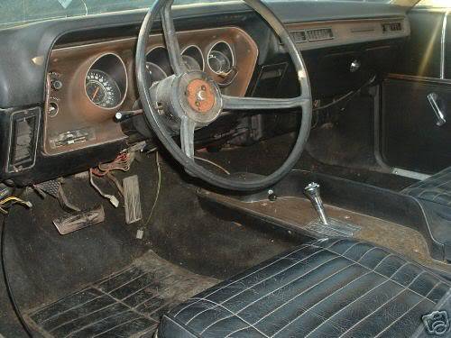

The original post pics are not my car... below is the beautiful interior that has become my refuge from the 2 kid insanity in my house...

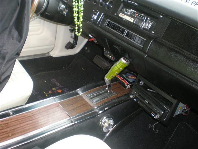

I could be wrong but isn't that a Cordoba/ Magnum shifter. Thats different. Does it ratchet like a slapstik? Man, you guys kill me with interiors in your car. Mines stripped, waiting on a top and headliner. 80 degree weather and garage bound.
it does shift like a slap stick...not sure what it came from..was in the car when i got her.
