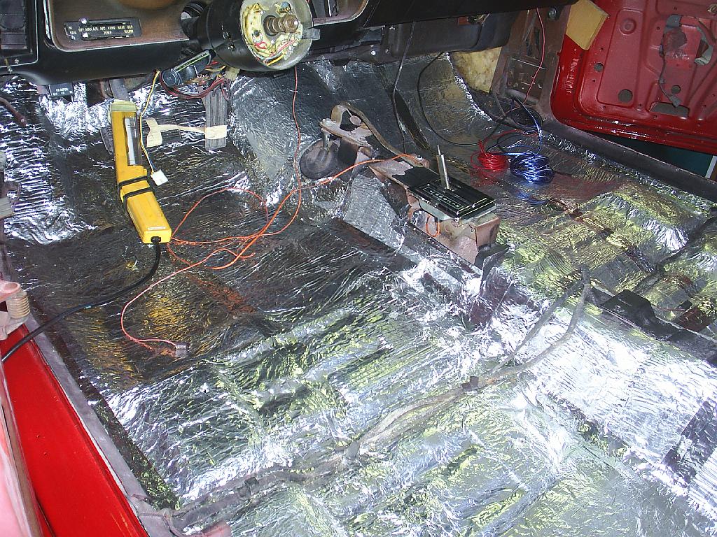

Here is a pic of mine (73)

I can send you a couple larger pics if you like. But those are basically it.
