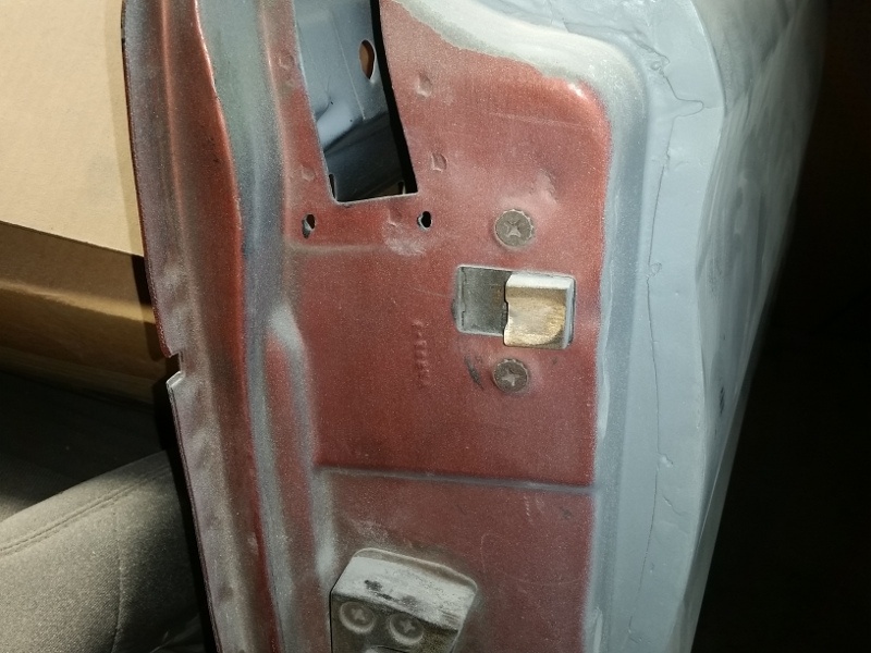

Adding this picture from the door frame on my 67 Belvedere Convertible . . . just so it can be documented on this site . . .
The wedge bolted to the door and the striker assembly bolted to the jamb lend some support to help keep the body aligned. The wedge on the door will contact the sliding portion of the striker in the jamb as you close the door and once the wedge is tight but the door is still not completely closed the brass piece in the jamb slides to the side to allow full closure of the door.
Hope you can make sense of what I am trying to say.
