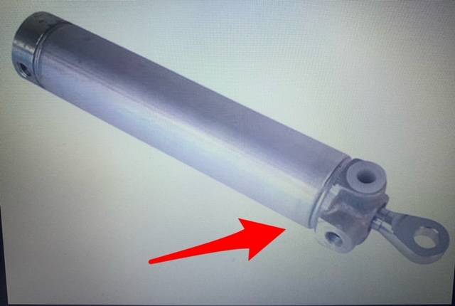

Problem is the top gland is retained by the tube being compressed into the groove in the gland.... How do you disassemble the cylinder without destroying it?
And since the rod eye is not removable from the rod you can't service the rod seal without disassembling the cylinder....

That makes sense.
I've rebuilt cylinders in the past that had threaded ends.
I'm surprised that 60's cylinders are not rebuildable.
