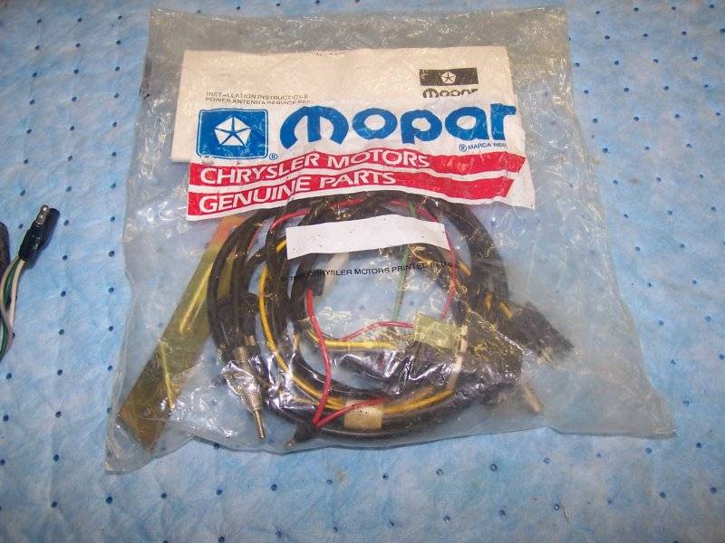

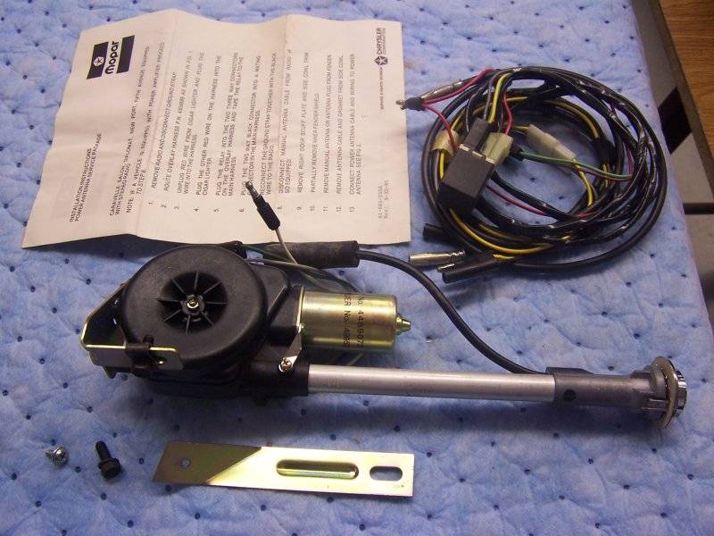

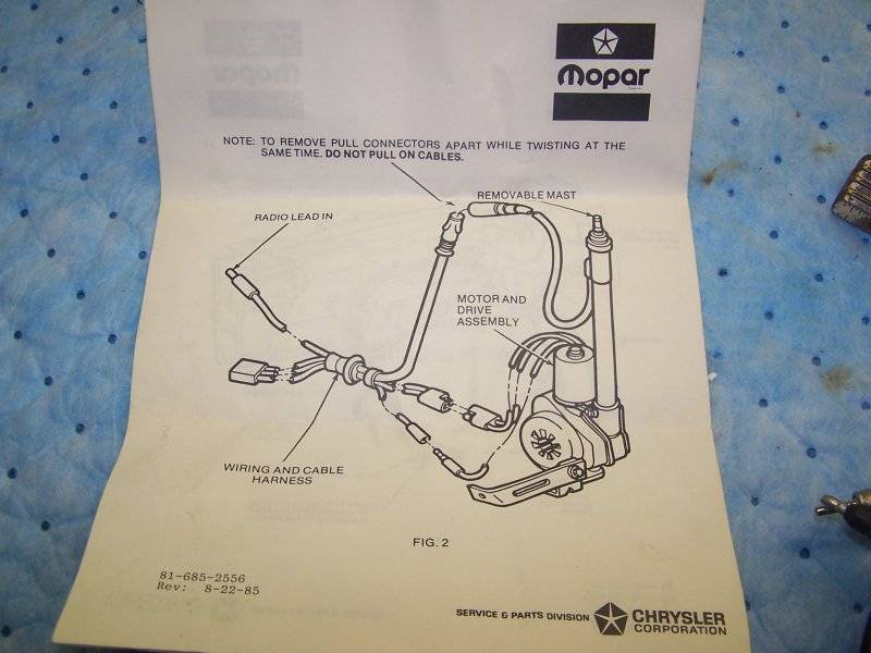

I have a new Mopar power antenna for a 5th Avenue that may work for you. I bought it to install in the trunk of my E body but never got around to it. You would need 13" from the top of your fender to mount it.
Here are some pics. PM me if interested.
Pull the tire off and the splash shield between the fender and firewall off. Plenty of room to work on it in there.

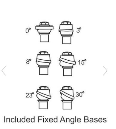

It only has the one angle. Like the top one....zero degrees.
Just to let you know, someone else has an interest in it but I told him you are first in line since you started the thread.
Thanks for your consideration. It looks like mine needs the 8* base, so if the other guy can use the 0* base he's welcome to it.

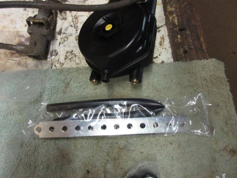

After a few months, I finally got around to this job -
This is the Corvette antenna twecomm suggested in post #4.
It has the bottom mount, I'm wondering if Chrysler put something in that area for their retractable antenna to bolt too? Anyone know or have pics?

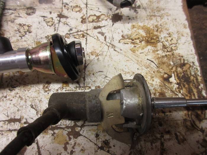

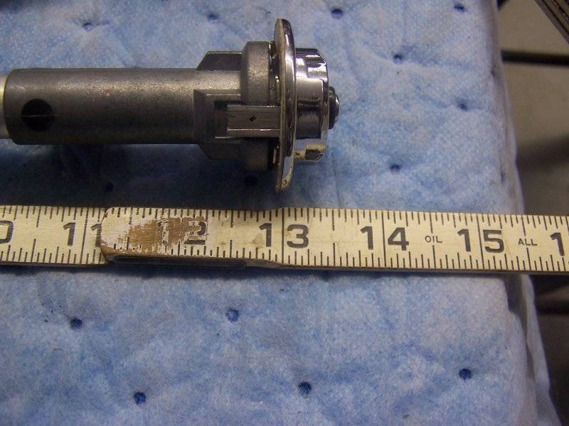

The top mount on the factory whip antenna is substantially stouter than the Groove Shark antenna -

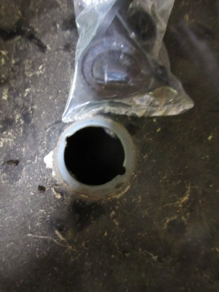

I'm not sure any of the top mount pieces are big enough for the hole in the Charger's fender -
Now that I've got my factory whip antenna out and can see how it goes together, in retrospect I wish I'd picked up the factory retract antenna from Sixpactogo. I bet my top mount hardware would have swapped over. it won't with the Groove Shark antenna.
