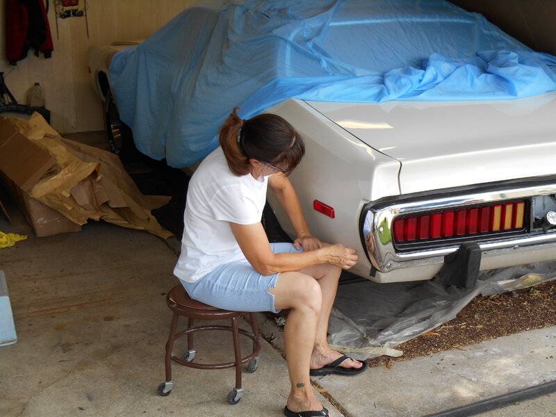

No, I did not tuck them in. The wife gets credit for making the molding that covers that gap in the front and the back.
She found a 16' roll of rubber at Menards that seals on garage doors. It has the L fold that fits perfect. So far, have gotten great compliments on the idea. I'm sure there are those that would prefer the real molding but try and find a decent set.

Hank, that's a great idea using the garage door seal. From what I hear it isn't reproduced either. I guess it was Doug Larsen who posted the thread about how to notch the bumper brackets so the filler could be removed.
