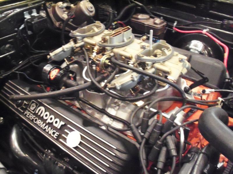

Any advice or suggestions would be greatly appreciated. I will upload a photo of the engine for your viewing pleasure.

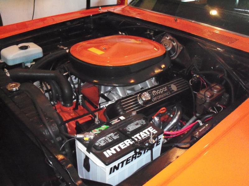

Just for your viewing pleasure another photo of the engine
