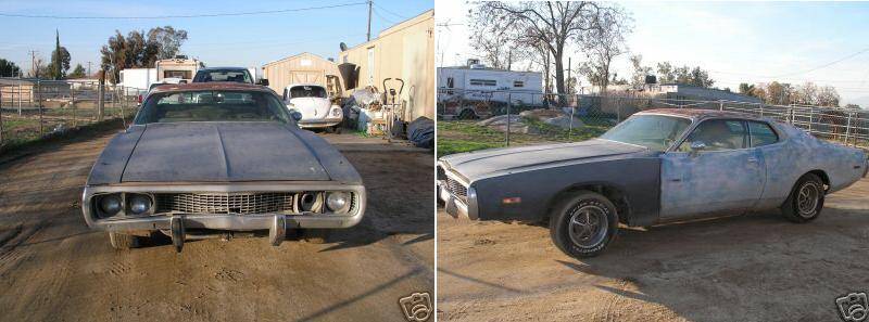

these ones ?
I had more of an orange 72 Charger in Vzla, nicelly done but with a Coronet bumper. But lost them somewhere.
