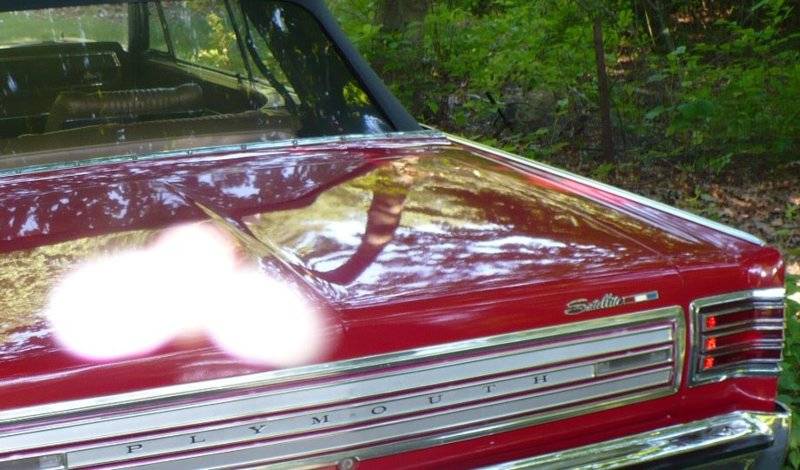

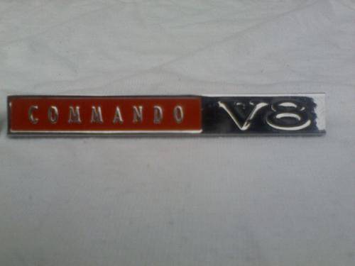

Picking up a 1966 satellite convertible tomorrow that someone started to make a GTX clone out of it. it currently has "belvedere II GTX" emblems on both front fenders, trunk lid and also on the glove box door. Looking for information on installing the correct Satellite Emblems back on the car...Car has the stock 361 in it.
Front fenders should say Satellite and trunk Satellite with flag, see pic. Engine callout??? My Satellite.
A 361 car would have "Commando V8" emblems.
