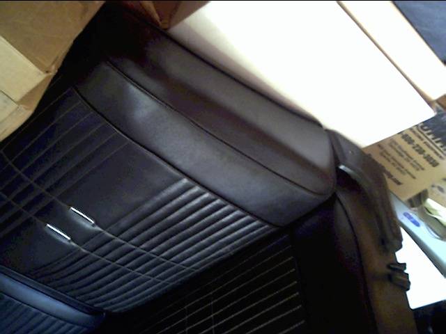

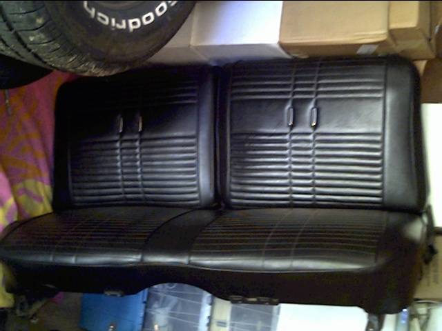

here a 68 RR Black (decore package) front black seat below
it was a folding forward seat, split 50/50 bench seat
org. from my 68 RR RM23 HT
the smooth pattern in the center of the seats (front & rears)
is usually a non Décor package, standard base model seats
they had release levers to fold the seat forward too
most of them were 2-tone also, not 1 solid color,
the center squares was a different shade if that makes any sense...
(from my experience anyway, I've owned 8) 68 RRs & 13) 68-70 RR's in total)
all 68 RR had a split bench seat, décor package or not
buckets or a console, were not available[/] in the RR, not in 1968
I sold it to a FBBO member here, a few years ago for $250
they came & picked it up, saved a few hundred in shipping
sorry that's the only photos I kept/stored
it did have the little square-ish chrome knobbed/levers
in the back on the bottom, on both sides L & R to release the seat
so people could get in & out of the back
hope it helps

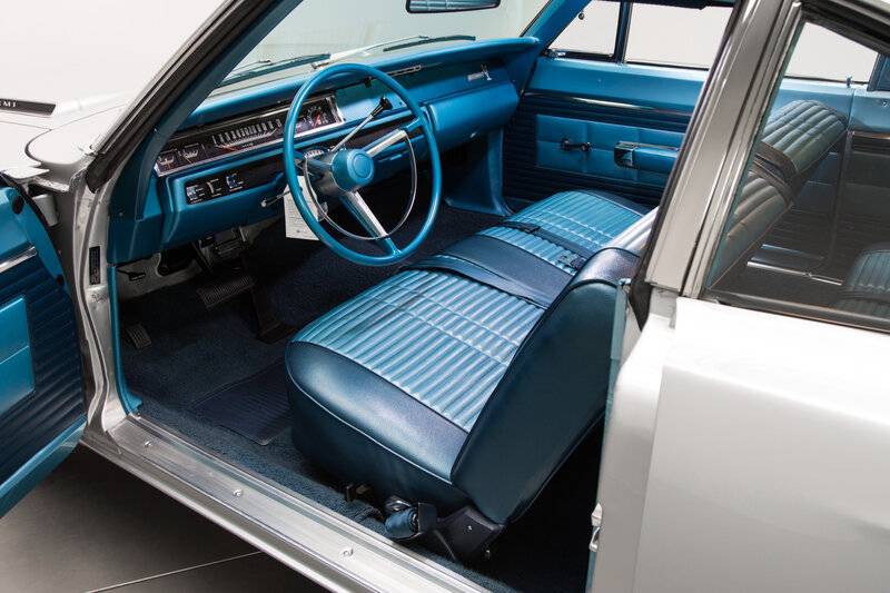

here's another FBBO members front bench seat in a 68 Hemi RR
you can see the pattern better
