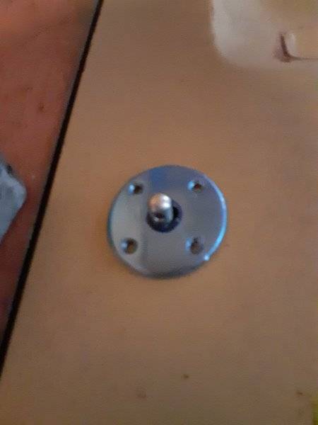

Good evening: Did the 1971 doge charger hood pin plate come with 3 screws or four? I've seen both lately. But four screws seems to be the most cpommon.
Thanks!
Mark
4 and its a beveled plate not flat.
The correct bezels look like this.
.....and before you drill in the wrong place, like so many do.....
.....look at the under side of the hood and you will see the correct location clearly laid out as there is a "hole" already stamped in the bracing.
