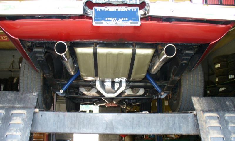

I have 255-60 on the back too - BFG Radial T/A. Here is a picture of the car on a lift so you can see what I mean about the clearance with the springs. It's actually a little more than it appears in this view. I measured it at approx 1".

Thanks guys that clears things up nicely and with tire options noted.
