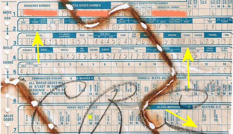

69_900_assembly_carb.jpgThe 69 B body automatic (D32) without A/C (H11) 330 horse assembly is ENGINE (assembly) 900. That, typically, calls for CARB 38 or the Holley R4440. However, I have seen one BS listing a Carter. Unless you have the BS showing the Carter, I would go with the 4440.
