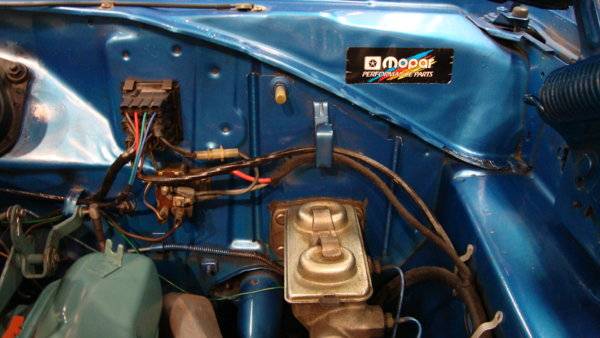

My '69 looks like gold to me. Manual drum. This is the best picture I have.

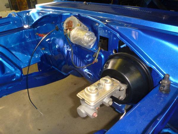

CBCC0401 Champagne Pearl... if you don't wanna pay the plater. Natural on the clamp (coated in RPM). I've seen a lot of gold plate on the old rectangle and silver on the rounded front masters. :rolleyes:

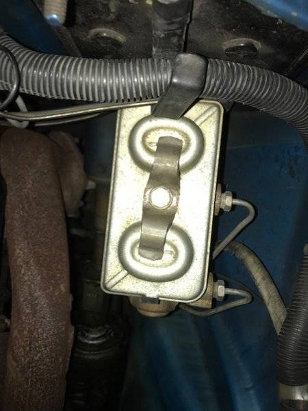

Standby, I'll go out, uncover it and get a picture for you.
EDIT: to add photo
FWIW...my 68 GTX, Manual drums.

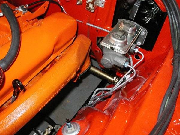

Below is a picture of a 100% OE restoration......69 Daytona....I have many other pics at home and this is a fine example.....Furthermore, I think this question also came up in that build thread and was debunked...
