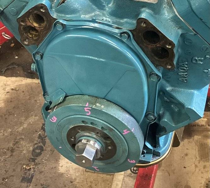

Greetings BBuddies:
The Google resources said 1 1/4" so I bought a 6 point 1/2 drive impact socket from Harbor Freight and it is too big, with aluminum foil covering the bolt head it grabs and can turn but I don't want to damage the bolt or worse slip off and damage my knuckles lol. My Nova neighbor brought over a 1 1/8" and that is too small. Is a 1 3/16" just right? It seems like quite an uncommon size... Maybe it's Metric?!?
Please advise - I'm looking to find #1 TDC to fit my distributor correctly and this seemed like the best and safest method...

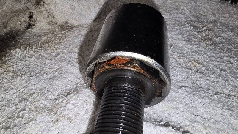

I have 10 crank bolts here from both big and small blocks, they are all 1 1/4".
Thank you! maybe the Harbor Freight Impact Socket is junk ($4.99) lol. Is your 1 1/4" socket 12 or 6 point or did you just meaure the bolt(s)?

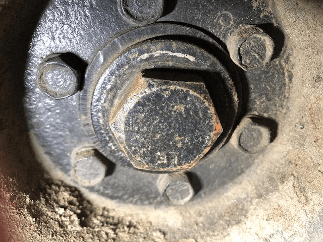

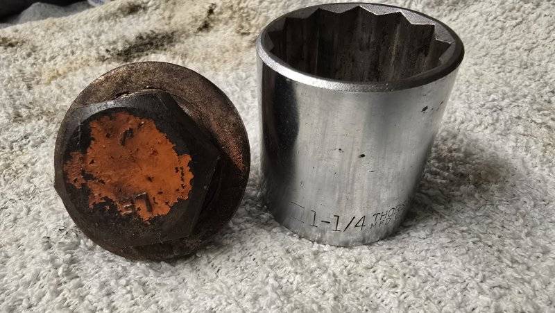

*Also, do your bolts look like mine (pictured above) with "LE" marking and tapered edges and shallow?

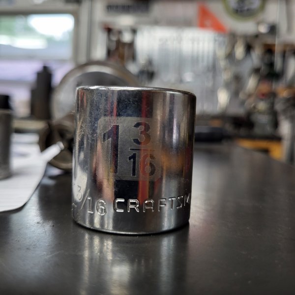

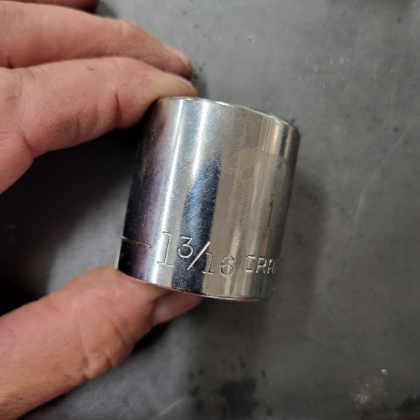

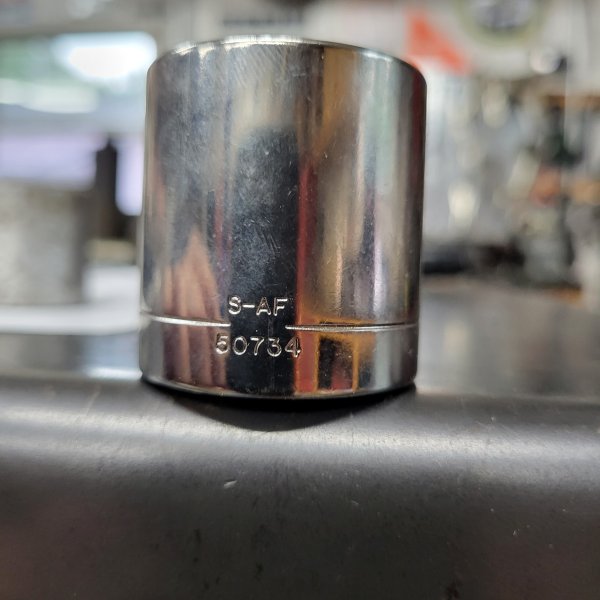

1-3/16 won't go on mine. 12 point 1-1/4 Craftsman is loose but it's what I use.
You could get a slightly deeper bite on the bolt head grinding the lead off the socket.
1-1/4" on my 1970 383 Magnum
Fit-checked using the 12 point I had handy.
