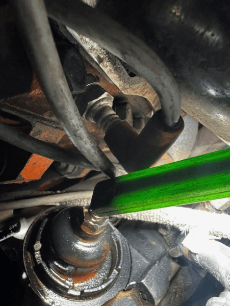

I have a 69 440 charger with an Automatic Transmission. The steering box needs to be replaced but the garage said they can't see what make or model the existing one is.
Does anyone know what the correct box would be for my car?

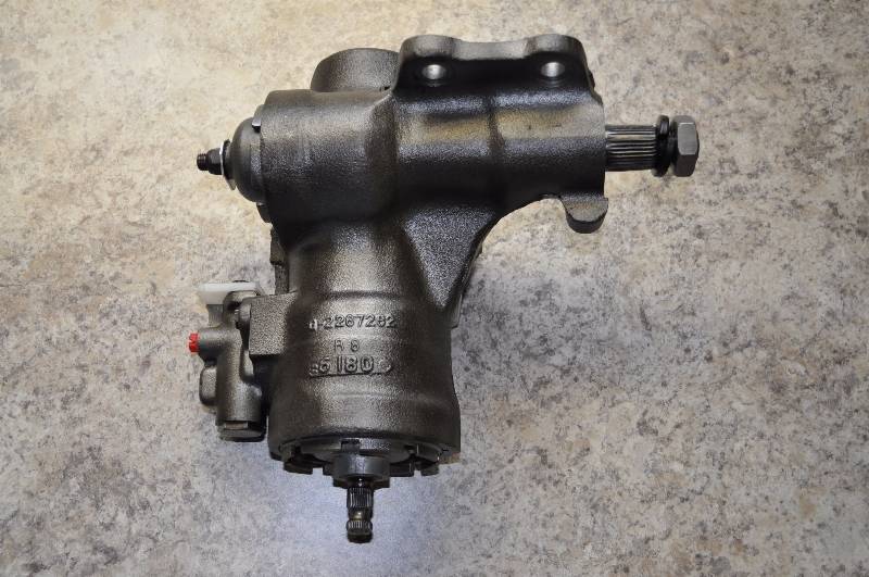

This one. Used from early 60's all the way till they stopped doing rear wheel drive cars. Also used in the B-Vans to the early 90's. If you're going for a stocker, buy from Firm Feel, Redhead or Steer and Gear. They truly REBUILD the units. Unlike parts stores and some other sources which use suppliers that will only replace a seal if they can get away with it. The kicker is the amount of useable cores left for these companies to work with. The internal main gear units aren't reproduced, so they have to find the best of their core selection on those plus find the best housing. Many people talk about having a dead spot in the box when going straight. Thats worn gear teeth. If you want a new box, Lares[ which I just put in my 67 wagon] or Borgeson from Peter at BAC[ have that for my 65, but have not used it yet]. Many people love the Borgeson, but it is more than the Lares. Borgeson is smaller than stock, or Lares, and may fit better in your car with less hassle.
Power Steering Box
All FFI Power Steering boxes are thoroughly cleaned and inspected; the cases are machined for roller bearing sector supports, and the worm gear assemblies are resized. The box is then fitted with Firm Feel's exclusive reaction springs, ranging in three steps from slightly firmer than the OE police box to two steps firmer yet, depending on your needs. All boxes are bench tested and shipped ready to install.​
Stages 0, I, II, III (Rebuilds)
PSB0(STOCK)$545
PSB1.......$500
PSB2.......$500
PSB3.......$525
Steering Core Charge
PSC........$250
High/Low Pressure Hoses
PSBPH.......$CALL​
Measure the pitman shaft out the bottom
1972 or 1973 said shaft is larger than the earlier ones
Otherwise the boxes are 100% interchangable

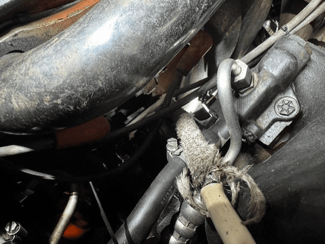

There is an existing one on my car that the garage thats working on it can't identify.
They said they would have to order a new box which may not be correct and would work out just over $1000 shipped to the u.k
