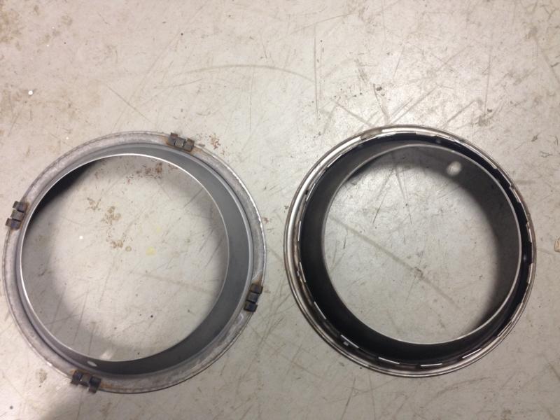

Who can identify the correct trim rings for my 70 Bee with Rally wheels (road wheels)? Help is appreciated! IMG_0236.jpgIMG_0235.jpg
First off a Road wheel is a 5 spoke wheel with a trim ring, a Rallye wheel is the argent painted wheel with a series of holes and a trim ring.

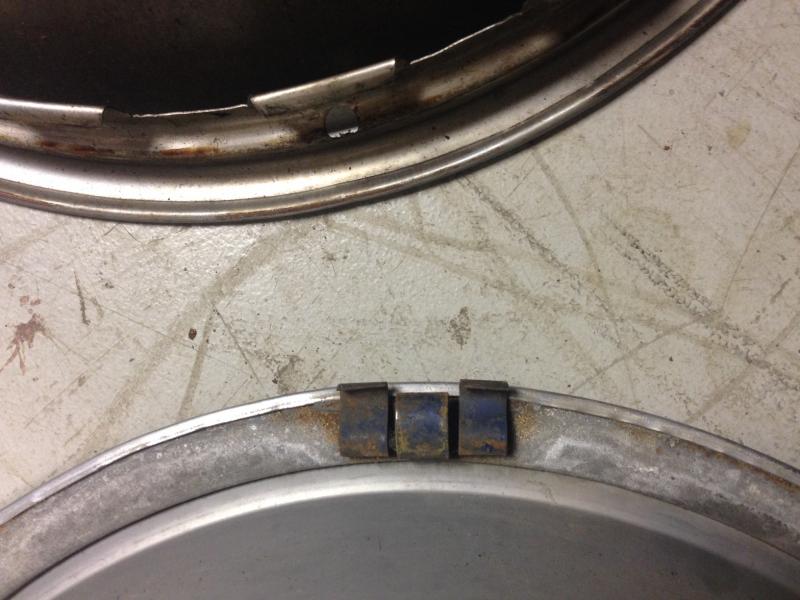

Going by the one picture you posted the trim ring on the left is a 69 with the 4 attaching points, the one on the right is the correct 70 style.
I bet the one you have on the left has a slight lip at the point where it would meet the wheel. That then for sure is a one year 69 ring.
I'm also assuming you are speaking of 14" wheels since there are no Road Wheels in 15".
Look on Moparts there is a very informative thread going on right now with many pictures.
