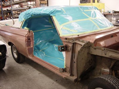

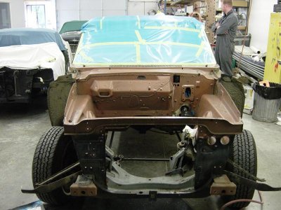

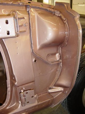

I have to patch an area by the right front wheel well. I have a new inner fender splash shield but part of heater box? and firewall? need some attention. I am guessing that the front part is solid with no openings and that the oval hole on the side is where air can get into the car?
Thanks
?View attachment 97633
These are about the best photos I have that were taken during the restoration of my 65 Belvedere II convertible. Hope these help sort out your efforts,
Arland
